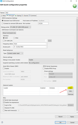

As a workaround, if you open the .project file in an editor, you should be able to replace the name of your project.

You might also need to set the external loader in the Run/Debug Settings, to be able to run your project on target.
Hope it helps.
Osman SOYKURT
@Osman SOYKURT , thank you for your help on this. It took a LOT of effort, but I was able to change the Application name in seven files so that it imported into CubeIDE uniquely and properly. It also took some work in the CM4 and CM7 Run/Debug Configurations (as you hinted at), but this was relatively easy.
