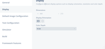

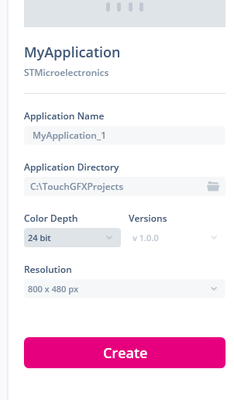

I'm developing a TouchGFX application for my company. For proof of concept, we used discovery board (STM32H750B) which had 16bit LCD panel. Further for production we developed our own custom board with same controller but LCD panel is 24bit. I tried to create a .tpa file as per the Creating an TouchGFX Board Setup | TouchGFX Documentation. I edited the Json file and created the .tpa file for custom board. But the changes are visible in create page only and the change didn't reflect on configuration page. have a look at the attachments for clarity.
Can you help to fix this issue.
