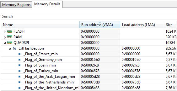

All is building perfectly and when I look at the Build Analyzer, I can see the ExtFlashSection and my assets under QUADSPI, all seems in order:
The problem is, when I launch the debug, it seems that the flash is not programmed and my screen print this instead of my beautiful picture :(

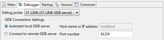

2019-05-14 12:40 AM
Hi Martin,
Sorry, I wasn't clear in my first message, I'm using STM32CubeIDE with my STM32F746G-discovery, I have tried Atollic but I'm not using it. When debugging or programming, STM32CubeIDE use ST-LINK:
Thank you,
Charles

2019-05-14 02:29 AM
In fact, I just realize that I didn't really need STM32CubeProgrammer or ST-Link to set up the external loader.
It is possible to set it up in STM32CubeIDE by going in:
Run>Debug Configurations>STM32 MCU Debuging>"yourapp.elf">Debugger and then check "External Loader" and type "N25Q128A_STM32F746G-DISCO, 0x90000000, NOR_FLASH, N25Q128A_STM32F746G-DISCO.stldr" (in my case), the scan button don't work and find an innacurate loader.
I had already set this external loader with STM32CubeProgrammer so I don't now if it was necessary. I will try it on free time but I think that only the CubeIDE config is necessary.
Now everything is set up, I can flash from CubeIDE with on click :D
