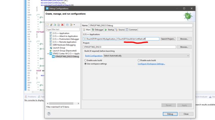

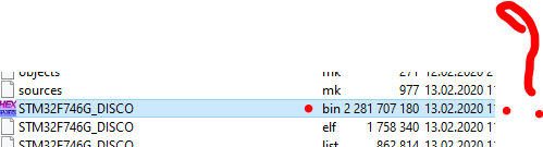

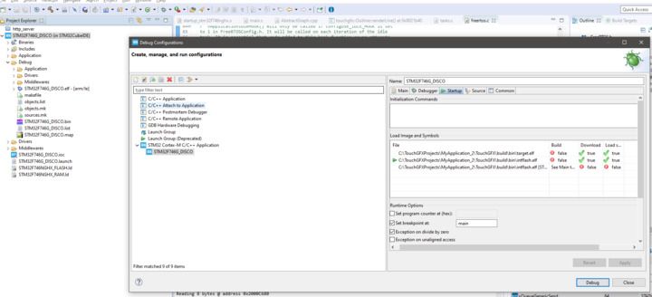

Hi there! Is somebody have the issue with external memory programming? I nave not issue when i try to run code from TouchGFX designer, but the same code do not work from CubeIDE. And one more strange thing .bin file from CubeIDE have size more than 2GB!!! Debug have been failed every time in stage external flash programming with output:
(Read)Failed determine breakpoint type
Error! Failed to read target status
Debugger connection lost.
Shutting down...
I have found only one way to debug - to add files from GFX folder to debug settings. First add external flash file than internal. It works for me...
Do someone have any ideas?

I faced with number of issues that TouchGFX generate two files:
a)
1)intflash.elf
2)target.elf
But CubeIDE generate one *.elf that have size less then sum of those two, and one BIG *.bin file. (look at the picture above)
b)
I find a tri�?k to run it in debug, but it is annoying - very slow to upload with any types of ICD (J-Ling-mode and native STlink)
