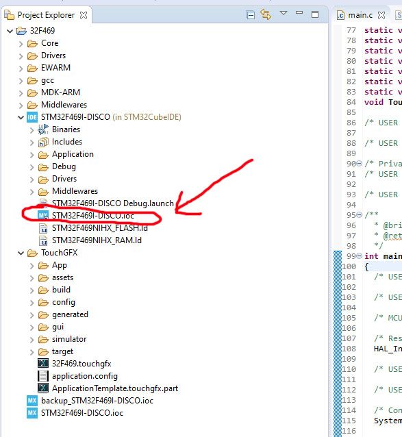

please fix the compatibility bug in new Touch GFX 4.14 and CubeMX 6.0 and Cube IDE1.4
MNapi
Senior III
this is the error I am getting once I migrate or click continue when I open project in CubeMX 6.0 or CubeIDE 1.4 created in TouchGFX 4.14
then screen created in TouchGFX will not longer display, it just dark.

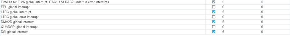

Hello @MNapi​ ,
After some investigation, your problem might be due to NVIC priorities being reset.
Indeed, when updating to CubeMX 6.0.0, the NVIC priorities are reset because the CubeMX team made some changes regarding the priorities linked to FreeRTOS. This is a bug that is only noticeable when using FreeRTOS. If the priorities are at 0 the interrupts won't be triggered. So set the priorities of interrupts that are enabled such as LTDC or DMA to 5.
Tell me if it solves your issue.
/Alexandre

Hello @MNapi​
I downloaded your project and it was working correctly with no issue. I tried on a F469-DISCO board.
Let me explain what I did.
First here are the software versions I used:
  • TouchGFX 4.14
  • CubeMX 6.0.1
  • CubeIDE 1.4.1
  • Keil 5.31
  • CubeProgrammer 2.4.0
Now here are the steps :
  • Open STM32F469I-DISCO.ioc file in CubeMX
  • Change the NVIC priorities (see below)
  • Generate code in CubeMX
  • Open application.touchgfx in TouchGFX Designer
  • Generate code
  • Run Target : it worked
  • Then opened the .project inside the folder STM32CubeIDE/ in CubeIDE
  • Build and download using STM32CubeProgrammer : it worked
  • Change IDE in CubeMX from CubeIDE to MDK-ARM
  • Generate code with CubeMX
  • Generate code with Designer
  • Open project in Keil
I don't understand where you found a problem.
/Alexandre
