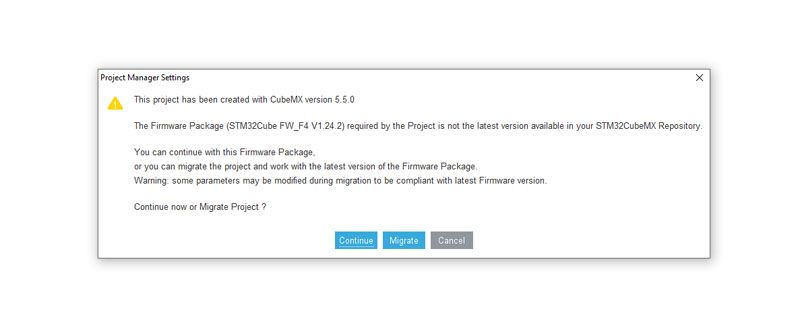

this is the error I am getting once I migrate or click continue when I open project in CubeMX 6.0 or CubeIDE 1.4 created in TouchGFX 4.14
then screen created in TouchGFX will not longer display, it just dark.

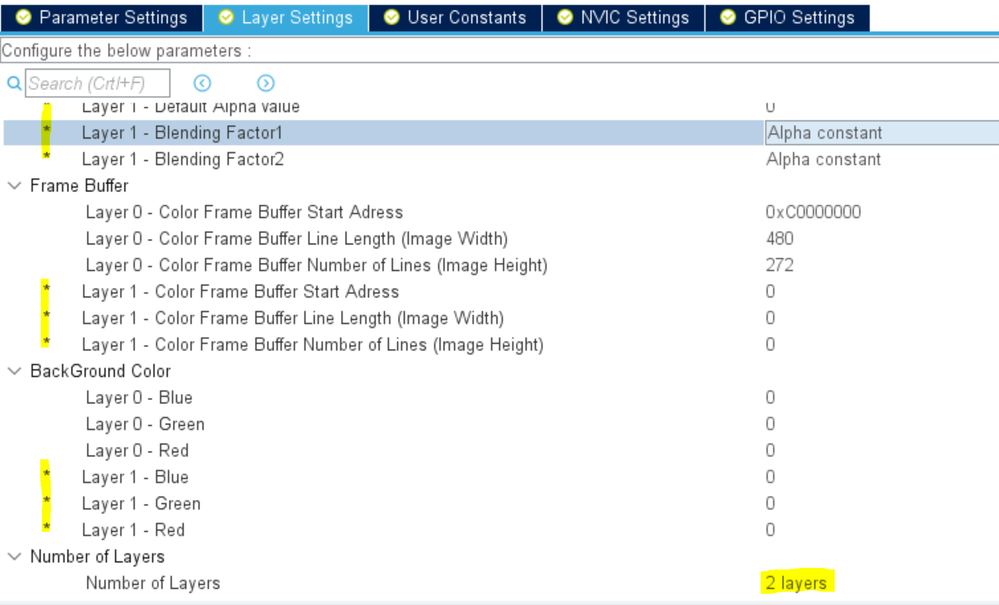

What board are you using ? Did you correctly change the TouchGFX Generator version to 4.14 in CubeMX 6.0.0 ?
Also, CubeMX 6.0.0 generates a second layer even though you do not set it. It's a CubeMX bug that will hopefully be fixed soon.
In the meantime, to change it, enable the second layer and set everything to 0 (it should already be the case but verify when enabling)

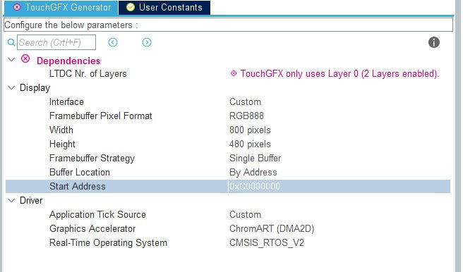

I did as you suggested and it did not work the same problem as soon as I open project in CubeIDE 1.4 the screen goes dark and this is the error I got when I changed to 2 layers I am using STM32F469 Discovery. And I have changed in Cube IDE and Cube MX to version TouchGFX 4.14
The issue in your screenshot is a consequence of the 2 layer issue. It is a warning rather than an issue, you can still generate code from CubeMX.

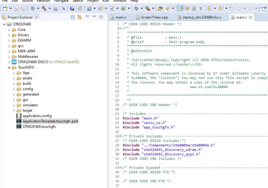

I started project in CubeIDE 1.4 I checked all the parameters to work with 32F469 Discovery, then I click on ApplicationTemplate.touchgfx.part to open TochGFX 1.41, I did some basic screen. It created new files. It did compile, upload and black screen.
Then I tried to create first screen in Touch GFX it worked when I run target. then I open project in Cube IDE 1.4 (like on the picture below) it is asking me to migrate or continue. It did complie with no errors and balck screen when I upload. I tried to run target again from touchGFX and it stop working, black screen.

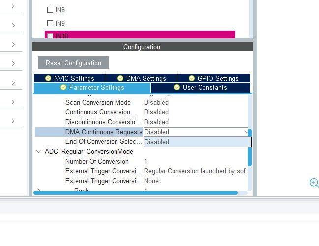

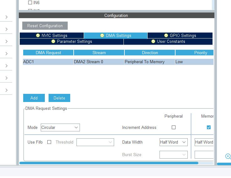

see the picture below CubeMX 5.5 and CubeIDE 1.2 does not allow to enable continues DMA request for ADC for STM32F469 Discovery, I see it was fixed in new Cube MX 6.0 and Cube IDE 1.4. This is why I wanted to upgrade but I cannot.
