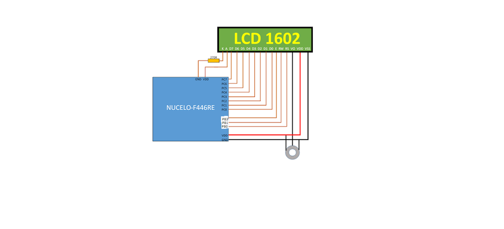

Hello all members,
I am interfacing LCD module in 8bit mode to STM32F446RE Nucleo board the connections are as below:
0693W00000Lz4htQAB.pngThe pin connections(if unclear in diagram):
Control pins:
RS-->PB0
RW-->PB1
E-->PB3
8bit data pins LCD:
D0-D7-->PC0-PC7
Program Lcd.c:

Dear members,
I have pasted all my codes.. The GPIO.h,.c files are 100percent working fine I have checked with other peripheral projects. The delay function also works correctly tested for led blink...
Now I am stuck in LCD program only..
My main aim is to just display 1 character I have gone through datasheet and forums and have taken everyones's suggestion accurately I still can't figure out what's wrong with my program..
I have tried this LCD board for arduino program it works there.
Also I have checked voltage specifications and all pin's connected are 5v Tolerant as per stm32 datasheet.
Please can someone figure out whta I may be doing wrong..
Your suggestions may help me..
I would be greateful..

Do you have an oscilloscope or logic analyser to see what's actually happening on the wires?
Dear Andrew,
Thank you for your reply..
Unfortunately, I don't have an oscilloscope or logic analyzer..
That's going to make it very hard to debug, then!
Andrew Neil
@dk.2​ "pin connections(if unclear in diagram)"
Yes, the diagram is unclear - please post a better (higher resolution and/or bigger) one.
Are you sure that none of those connections clashes with anything on the Nucleo board?

I am using Nucleo board only for the LCD program now and nothing else is connected to the board..
I would have drawn the Image Instead I will mention the pinouts here
The exact pin connections are as follows:
LCD--->STM(nucleo)pins
VSS--->GND
VCC--->5V(arduino connector CN6)
VEE---->middle pin of pot of 10k & it's powered with 5V
RS------->PB0
RW------->PB1
E---------->PB3
DB0------->PC0
DB1-------->PC1
DB7---------->PC7
LED+-------->5V
LED- --------->330ohms resistor in series and connected to GND.
@dk.2​ "I am using Nucleo board only for the LCD program now and nothing else is connected to the board"
I meant, are you sure that there's nothing internal - on the Nucleo board itself - to interfere with your LCD connections?

How do I know if anything internally is connected I referred to pinouts in the below attached refrence manual from page 45 to page 56. I found no problem in using the pins I have used. Is there anything else I need to consider?
https://drive.google.com/file/d/1dnmLzKT0rNZPzQGTHeYhKHrsnxpciBTq/view?usp=sharing
Look at the board schematic:
https://www.st.com/en/evaluation-tools/nucleo-f446re.html#cad-resources
https://www.st.com/en/evaluation-tools/nucleo-f446re.html#documentation
dk.2
Hi Andrew,
I checked the schematic..except for pin PA2,PA3 which are connected to ST-link circuitry I don't find any issue in using PC0-PC6 pins for LCD. Can you please verify if I have got it right. I checked the schematic in above links.
