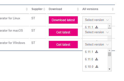

Visitor II
Jul 1, 2024 7:34 PM UTC
Why does it still show that the latest version is 6.11 here???

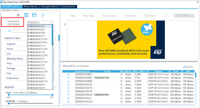

> Add support new CPNs STM32G4: Add support STM32G4 'Z’ and STM32G414
  • Community Psychiatric Nurse
  • Communist Party of Nepal
  • Common Peroneal Nerve
  • Coloured Petri Nets
  • Certified Pediatric Nurse
  • Chronic Pyelonephritis
  • Customer Priority Notice
  • Causal Probabilistic Network
  • Cognitive Packet Network
  • Custom Part Number
  • Customer Part Number
  • Catalog Part Number
Which one is it???
"- If someone's post helped resolve your issue, please thank them by clicking ""Accept as Solution"".- Please post an update with details once you've solved your issue. Your experience may help others."
Ghofrane GSOURI
Jul 2, 2024 9:03 AM UTC
Hello @BarryWhit
Support new CPNs (Commercial Part Number )STM32G4
STM32G473xx
STM32G414xx
Thx

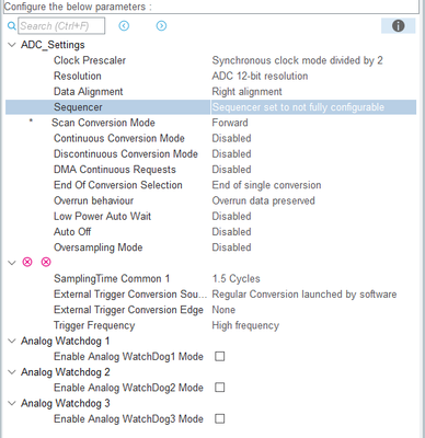

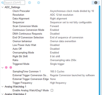

Jul 5, 2024 8:45 AM UTC
µC: STM32G070RBTx
after updating to 6.12.0, the code generator shows an error with the ADC configuration.
If I reset the configuration and start over, as soon as I set the Sequencer to "Not Fully Configurable", the error occurs:
Regards,
Edwin
Ghofrane GSOURI
Jul 5, 2024 9:09 AM UTC
Hello @EdwinID
First let me thank you for reporting.
This issue has been raised to our dev team (internal ticket 185851).
THX
Ghofrane
