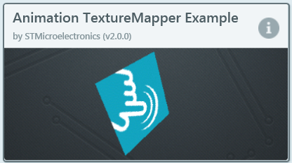

If performance is not much of an issue, I would give the TextureMapper a try. It is fairly straight forward, but I found that when I loaded the Animation TextureMapper Example (select it when creating a new project in the TouchGFX Designer), I was able to look at the code and get an idea of how to setup animation and rotation. Here is what that example looks like when selecting it in the project creation process:
And the great thing for you is that the TextureMapper is now part of the Designer! It was added in the latest release (4.12.3). I had to write code for it without the use of the designer in the previous release (4.10.0).
Basically you'd have your circle progress like you have and place a TextureMapper over that. Add the gradient haze image to the TextureMapper and rotate it accordingly.
