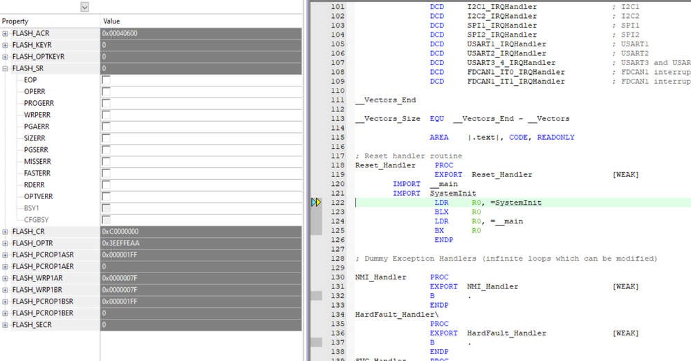

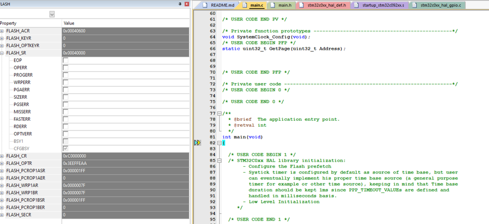

If I set a breakpoint with the emulator (then flash erase is fail) Then CFGBSY Bit of FLASH_SR register is set.
In this case program make the error.
I can fix this situation:
- HW Reset of emulator
- not using any breakpoints.
But the problem above is only result of longer research of my real flash problem in my application. But I hope we can fix this problem above and at the end of day my application is also running.
Situation where Flash example is running well:
Situation (with breakpoint inserted before download to CPU) Flash example will fail:
See the CFGBSY flag. The screenshot is after download program to CPU.
Hope this will help to find the problem.
