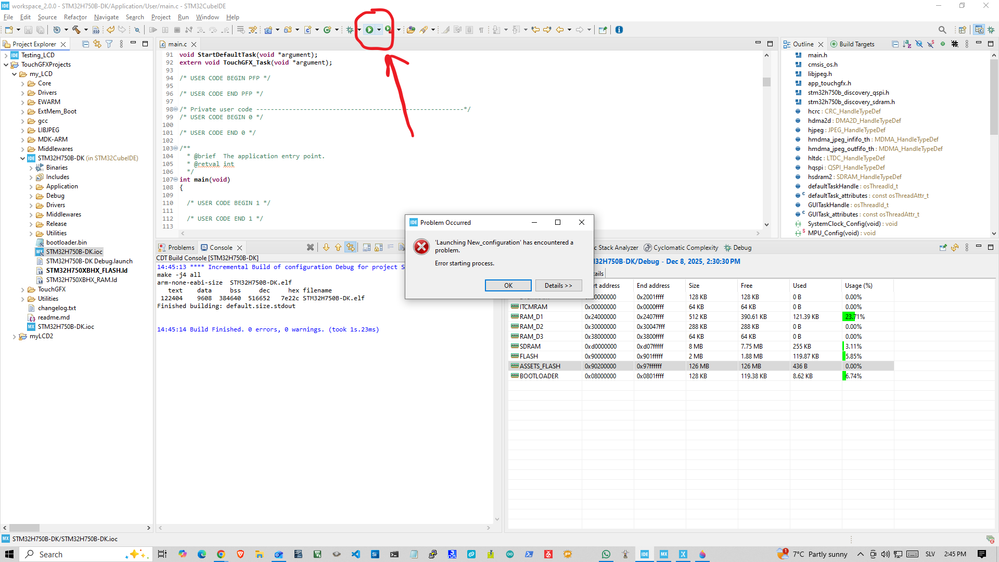

Hello all,

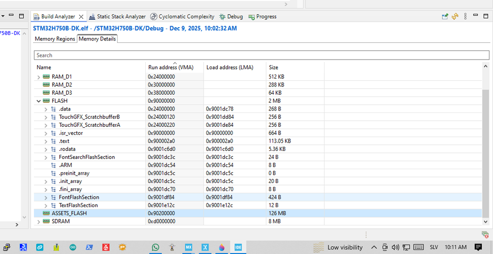

Trying to set up the custom display on the STM32H750B-DK dev board.
Interestingly, the display works via LTDC functions in Keil just fine... but I do not have much luck with the TouchGFX. For example, started with setting up the TBS in the Designer to avoid the complications of memory and other configurations (thanks to the ST support) and continuing in the CubeIDE where I have opened the .*.ioc file to update the MX configuration for the LTDC and TouchGFX... it compiles ok, I can opend the TouchGFX designer and "upload" the picture, for example, I can see the picture to be in the memory. See attached build memory analyzer.
However, when I run the application or debug, I cannot see the preview of the picture.
One of the ideas, as it is explained in the TouchGFX manual, namely Board bring up, would be to preview a simple framebuffer, not sure how easily that would be?
I am not sure how to tackle this problem, so any comments, ideas, or hints are more than welcome!
Best.
pic_in _memory.pnge memory

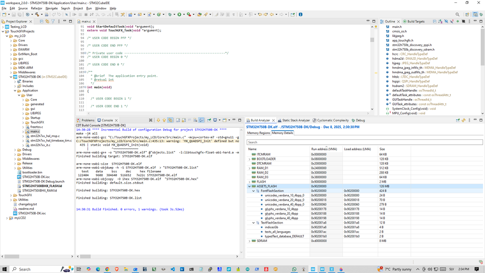

Started with the "Board bring up" as given by the STM manuals, got stuck here https://support.touchgfx.com/docs/development/board-bring-up/how-to/03-display-internal
I am not sure why I cannot store a simple framebuffer in the available memory cells.
I have reduced the size of the framebuffer to save memory... for testing....
//creating the framebuffer
uint16_t framebuffer_1[1024*60]; //16 bpp framebuffer
//storing the framebuffer to a particular memory
uint16_t* framebuffer_1 = (uint16_t*)0x30000000; //16 bpp framebuffer memory location
For example, I can see I have plenty of RAM, see the above picture about the available RAM...

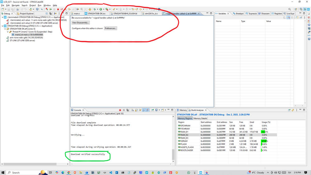

In addition, when trying to debug, it goes rather well; however, I get the following "error."
Any ideas on how to tackle these issues and make progress would be more than welcome!

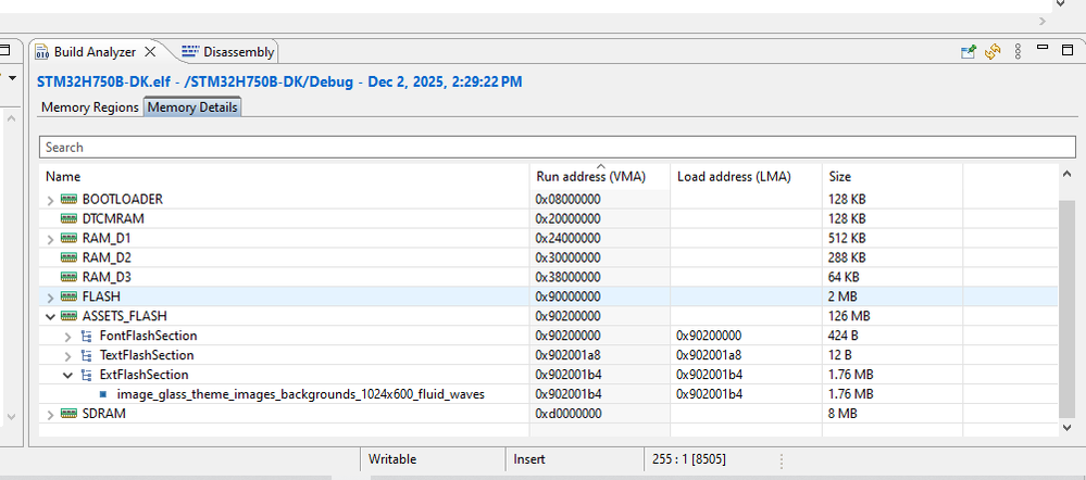

First thing, just try to display a red box using the "Box" widget in touchgfx. Remove all the images and text/fonts from your application. You should at this point have no data inside internal/external flash (you can verify that in the map file). Let me know if you can see the red box on your screen or not.

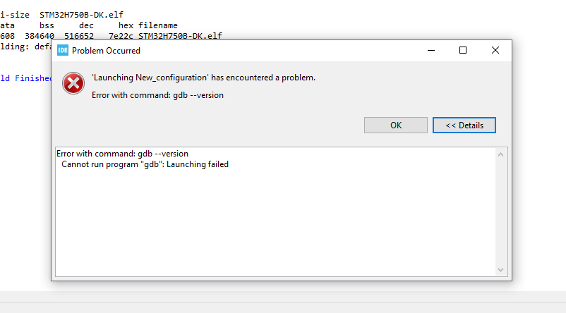

I cannot see the box, I cannot even "run the project", actually, how should I check I can see the box?
For example, if the "gren PLAY" icon is pressed, namely the Run... I get an error, see below:
Not sure about the map file? Where can I find it? It is not seen next to the *.ld exc. files...
Checked the Build analyzer and I can see the following:
It seems that there is 436B in it ?
I guess the pict. is not there anymore...

1. Yes, these are the fonts in external flash that comes with the default typographies in your TouchGFX Application. Just to make sure, you should put them in internal flash. For that, edit your linker script to have the font flash section and text flash section:
 FontFlashSection :
 *(FontFlashSection FontFlashSection.*)
 *(.gnu.linkonce.r.*)
 . = ALIGN(0x4);
 } >FLASH
 TextFlashSection :
 *(TextFlashSection TextFlashSection.*)
 . = ALIGN(0x4);
 } >FLASH

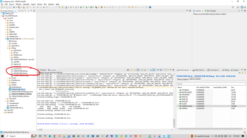

2. Could you try flashing using the STM32CubeProgrammer? (If needed, use the MT25TL01G_STM32H750B-DISCO)
3. The map file is located under the STM32CubeIDE/Debug/ folder (it ends with .map).
Dec 9, 2025 9:13 AM UTC
Re 1), corrected, compiles OK, and the "fonts" are in the internal flash...
Re 2), of course, I guess I should have used the *.hex file? BTW, where can the compiled *.hex file be found?
Re 3) Thank you!

I would also recommend you try to debug your application step by step and see what function it goes into before it breaks.
Dec 9, 2025 9:16 AM UTC
Not sure what you mean by that, can you give me an example?
So far, this is the problem?
It does not even want to start the debugging process...

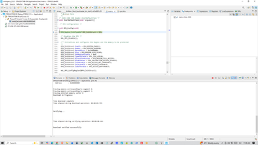

Re: Downloading with the programmer:
Enabled the creation of the *.hex  accordibng to this info https://community.st.com/t5/stm32cubeide-mcus/how-does-one-generate-a-hex-file-from-stm32cubeide/td-p/287131, appears in the "Debug" folder,
downloaded that file via the programmer, but nothing on the LCD, the LED on the top layer of the STM32H750b-dk is flashing (red, green)...
Dec 9, 2025 10:26 AM UTC
It looks like the debugging and downloading were solved;
When debugging is used, I land on this:
 When Resume or F8 is pressed, I get the following on my LCD, first it kind of flashes, like 1 second
then it settles...
