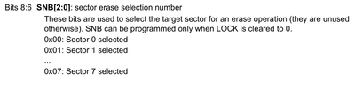

I have a requirement to implement CAN based bootloader in my STM32h503rbt6 controller. Right now iam working on the testing of Flash functions which i have written on my own.My flash write, read and erase all are working fine.but when iam erasing flash sector wise,here comes the problem.after sector 7, from sector 8 onwards with y function i cant abe to erase.but i want full memory controll over my st controller flash.then only i can decide which part of flash i can use for my bootloader and which part of flash i can use for my application.

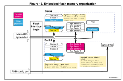

> I could not identify why erasing sectors beyond sector 7 is failing. Please help me identify the root cause and provide a proper solution.
The STM32H503RBT6 only has 8 sectors per bank. You can't erase sectors that don't exist. That is the root cause.
The proper solution would be to restrict yourself to sectors that exist, or move to a chip with more memory if you need it.
Maybe you meant to erase sector 0 of bank 2 rather than "sector 8".

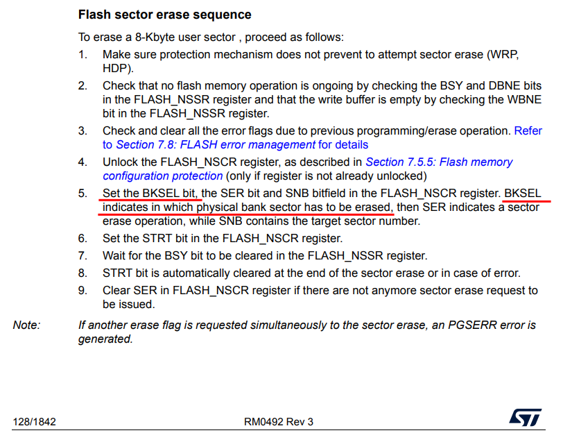

in that case how can i erase bank 2 sector 0.
gbm
Principal
Well, set the bank number to 1 and sector number to 0 in FLASH->CR.

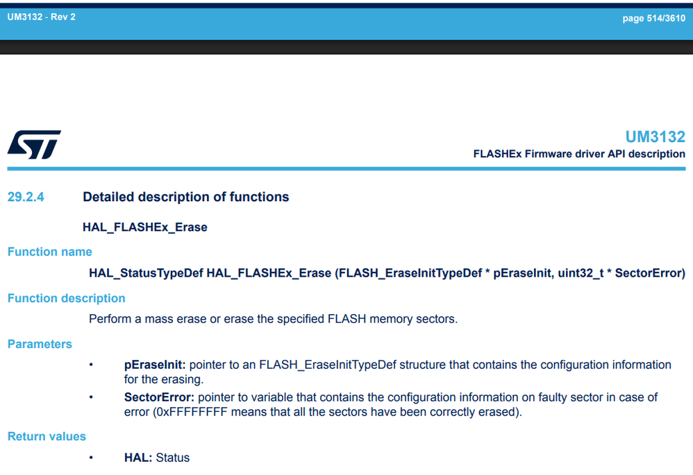

I suggest using HAL_FLASHEx_Erase.
stm32h5xx-hal-driver/Src/stm32h5xx_hal_flash_ex.c at b1ef40f3a522d073cfa70d647172206707acd740 · STMicroelectronics/stm32h5xx-hal-driver
Andrew Neil

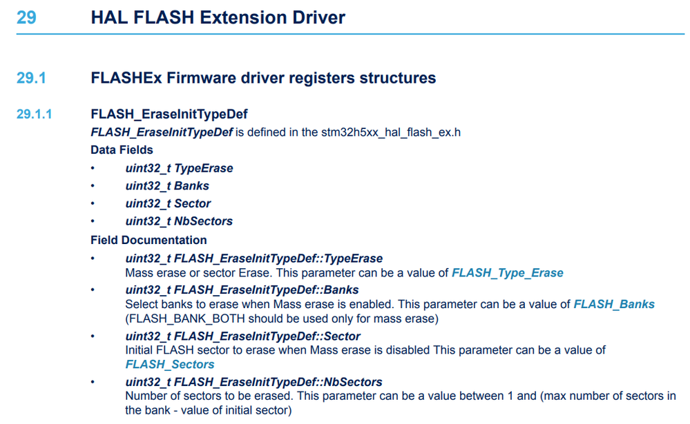

As @TDK said, look at the HAL_FLASHEx_Erase() function:
The FLASH_EraseInitTypeDef structure contains  fields to specify the Sector & Bank:
See: UM3132, Description of STM32H5 HAL and low-layer drivers

@PRAKKU12 wrote:
how can i erase bank 2 sector 0..
As @gbm suggested, you select the Bank in the Flash configuration register:
https://www.st.com/resource/en/reference_manual/rm0492-stm32h503-line-armbased-32bit-mcus-stmicroelectronics.pdf#page=128
