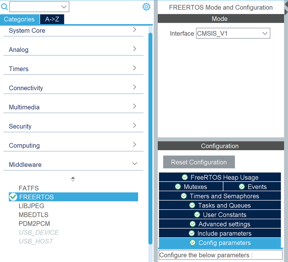

In MX wizard untick RTOS in touchgfx and addware config , delete manualy target folder in Touchgfx , after this close MX and generate bare metal code. Or create new project .
Switching methods in existed project dont work ok.

Too need disable 0693W00000QMbbMQAT.pngand clean refresh project after generate. Plus better is show error as share ...

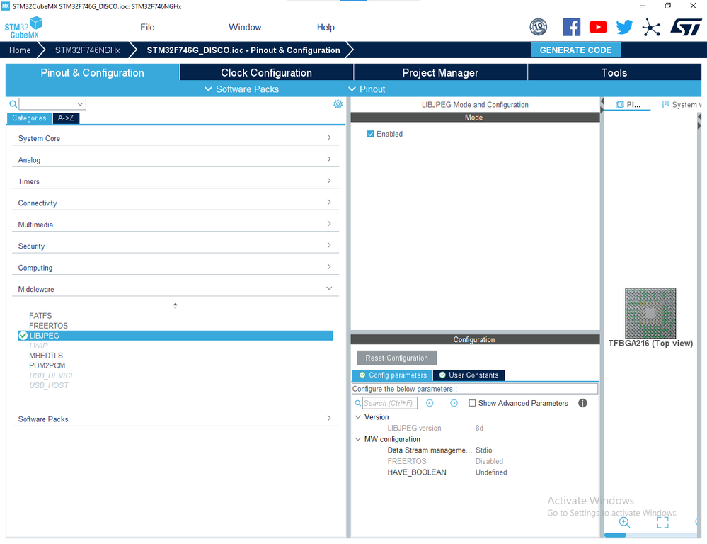

0693W00000QMisAQAT.png0693W00000QMis5QAD.pngHi...
I have disabled Free RTOS and regenerated the code. But It got hanged at hard fault handler.
