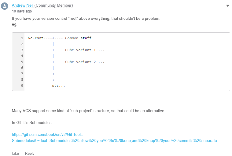

Problem:
The project contains core code c files as link in the project. It makes adding new files in common location ridiculously complicated and slow.
(Path: PROJECT/CM7/Core)
Workaround:
I remove the links to core files, I add a links to Core/Src and Core/Inc directories, works as charm. Now I can add files to those directories.
The catch:
Each time IOC file is changed, the IDE creates those links again and they must be manually deleted.
Where IS the folder structure and instructions to create those links?
There is similar problem with TouchGFX files (and the virtual folder structure is even crazier), but saving changes in IOC doesn't rebuild that structure.

‎2022-06-06 2:57 AM
Leave default folder structure as it is, let Cube and TouchGFX manage it as they want. But add a new link to your own code ​folder (and another one for includes, if you want, but it is not necessary)
Like this:
Project
- [Core​]
+ - main.c (link to file)
- [TouchGFX]
+ - MainView.cpp (link to file)
- [MyCode] (link to folder)
+​ - mycode.c

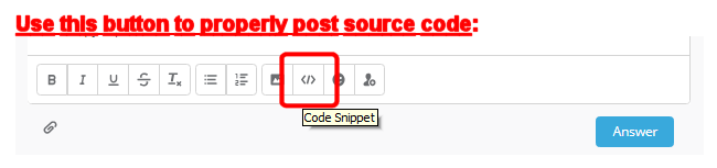

@ktrofimo​ you need to post as a 'Code snippet' for the formatting to work; eg,
‎2022-06-06 3:41 AM
That's what I tried to do in the first place, however, the compiler tried to compile the same files twice. That's the reason I deleted the original links. It's weird, because physically the files are not duplicated. Just in one virtual directory I had links to files, in another - the link was to physical directory. BTW, I've just launched TouchGFX designer and it removed all my C++ files from the Cube project. They are still on the disk, but the IDE links are broken.
I checked the build scripts, and as I expected, they contain physical paths, not the links. I don't quite understand how it works.
