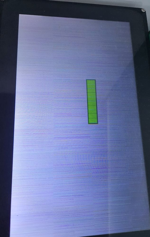

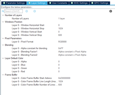

Hello friend!
Im working on TouchGFX GUI. Recently i have started learning thiis software using Diffrent diffrernt tutorials available online.
so i have configured FMC, I2C, Quad SPI, DMA2D and LTDC for STM32F746IGTx Controller according to the Data sheet of my touch Display.
After configuring every thing  in CubeMx i added simple background and one Flex Button in TouchGFX and through that button im calling LED Blink function.
so when i done my actual coding and dumped the code into my controller its showing only my button and instead of background image its showing me a flicking background.
But im able to touch the button and through that LED is also getting toggeled.
i have uploaded my project files below. please check it and guid me how i should get GUI properly on Touch Display..?

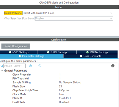

FMC config:
QUADSPI:

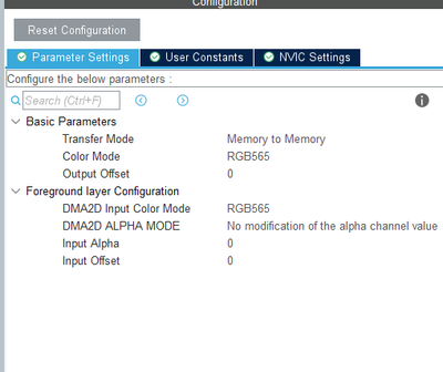

DMA2D:

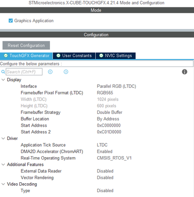

TouhGFX settings:

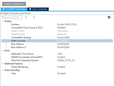

In touch gfx and layer setting you have configured pixel format RGB8888 meanwhile in layer setting it is RGB565.
Please try setting up RGB565 and try again.

i have tried variuose combination of RGB. but its giving same output. finally i got to know that problem is in QUADSPI. Beacuse instead of background image i taken a plane colour in backgoround. this back ground color got saved into my flash memory. and flickering also gone from display.

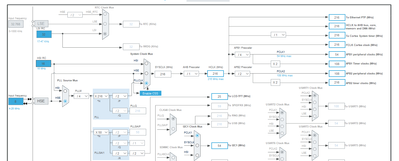

Try change layer config and touchgfx config to RGB565 ant clock ltdc to 33MHz or more

- Review the CLOCK from your display. Your current clock is low for this resolution. When you perform an animation or transition, you will have problems. If possible, share the link or datasheet here.
In my case, I use 44MHz, but my display supports up to 63MHz.

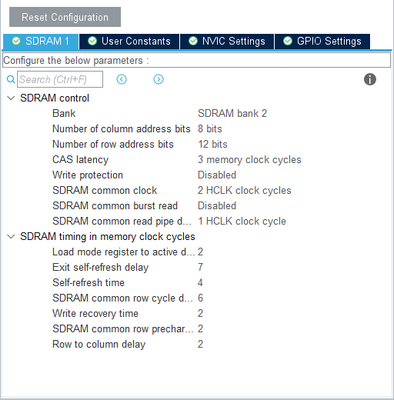

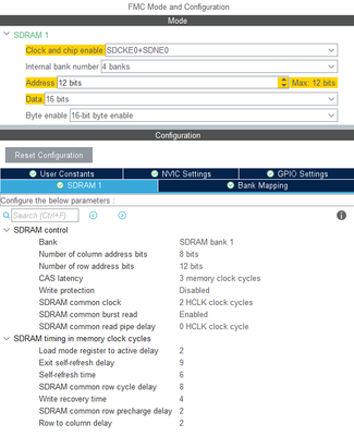

- Double check the SDRAM memory configurations. Is very importante the correct timming setup to not corrupt your image. This is a nice link that I discovery in ST community, that helps me a lot to understand how to properly do it. Share your SDRAM part number too. http://main.lv/writeup/stm32f4_sdram_configuration.md
This is my SDRAM setup. I use the PN IS42S16400J-7TL
I nice tip is after init the SDRAM is perform a insanity check writing in the SDRAM and read to compare if any value is corrupted. With it you will know the SDRAM is OK.

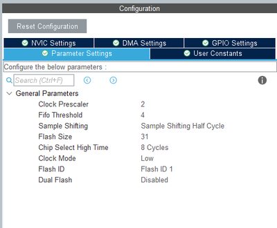

- About the NOR, Whats the clock? Are you putting it on Memory Mapped Mode? Check my setup for the same PN you are using.

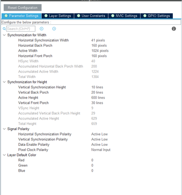

- LTDC: your setup seems OK. Just try put the Pixel Format to RGB565 to check if you not have perfomance issues. After validate it, change to test.
- DMA2D: seems ok for me
- TouchGFX: setup it to RGB565 either. I advise you to enable double frame buffer. It helps a lot when you have animations. Note the SDRAM NOR need to check ir your BANK. Check my setup
Important step. If you change the PIXEL format from RGB888 to RGB565 for instance, you need to open Touchgfx designer and regenerate the code. Check my TouchGFX setup, for scheme color.

and when im taking TFT display frequency more 25Mhz im getting blank display, i have tried 32mhz and 40.8Mhz frequencies but if im using 25mhz and below 25mhz im getting flickring display as mentioned above.
