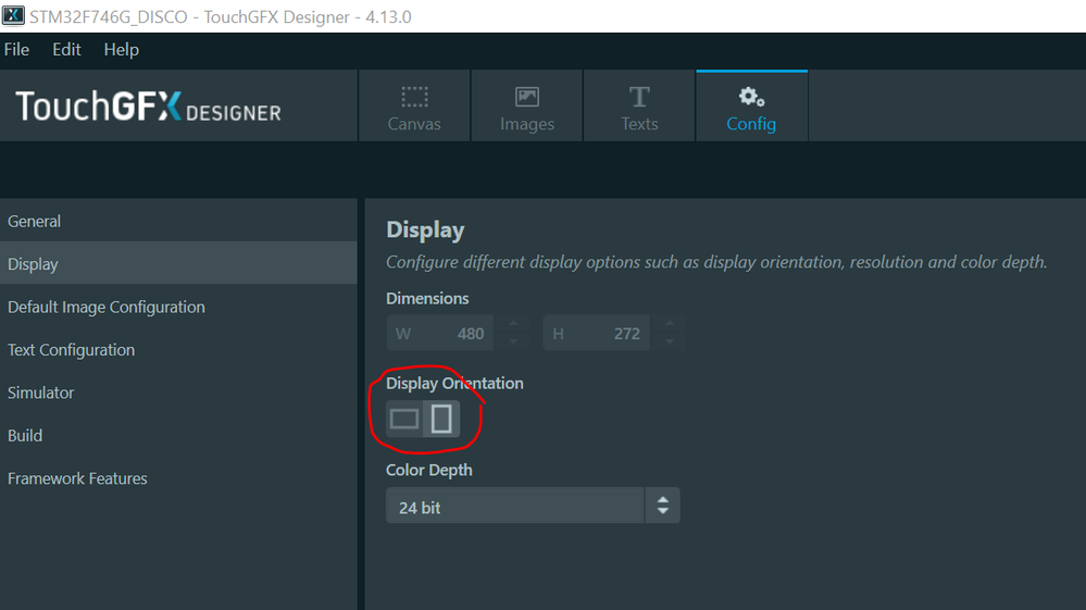

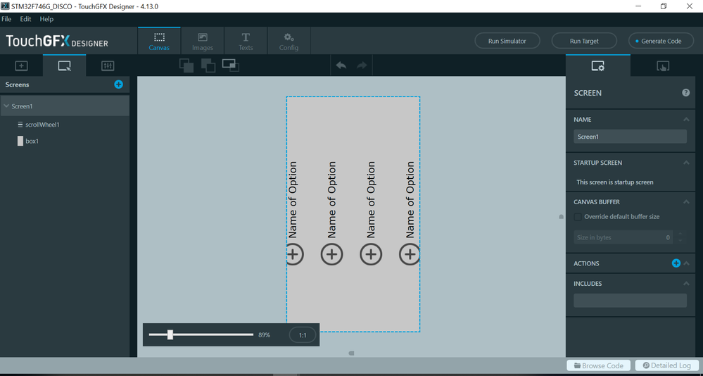

The swipeContainer does not handle vertical swiping. You can implement yours if you look at the available code but it might be a bit complicated. Another terrible solution I used once was to go in the Config tab and change the display Orientation.
Then I did my GUI sideways to simulate the board being hold sideways. You can then use the swipe container as a fake vertical swipe but it is annoying to adapt and rotate all your images/text/animations...
This was fine enough for a simple project, i would not recommend it for a huge and complex project.

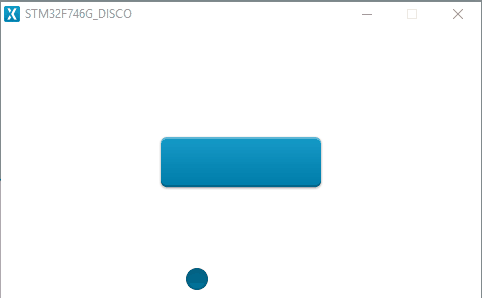

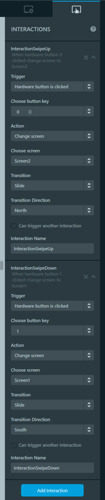

to simulate a vertical swipe container you can use the handleDragEvent function and set a distance the user has to drag before going to another screen. When you select the transition "Slide" and the correct direction it can give a smooth effect like the normal swipe container. You can develop yourself the threshold and elastic animation when you reach the border of a swipe container if necessary. I did a very short project so that you can have a look at the handleDragEvent function. I also added two fake interactions to enable the use of the swipe container functions with a specific animation ( slide north or south).0690X00000DCAU2QAP.png

wait have you tried to swipe up with my project? this is what i implemented. The horizontal swipeContainer is just here as an example. It is the best I can do to simulate a vertical swipe
