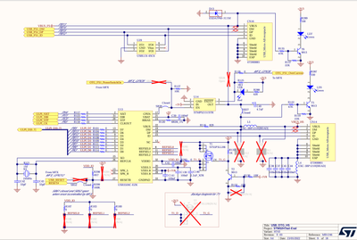

  3. This example uses USB_OTG_FS. I found code examples for USB_OTG_HS which is required in my case (6-10Gb of data to transfer). I was wondering if I need to simply add a USB controller between the STM32 and the USB port to support high-speed ? I did not find any example showing high-speed hardware implementation
You can refer to MB1246
Best regards,
FBL
