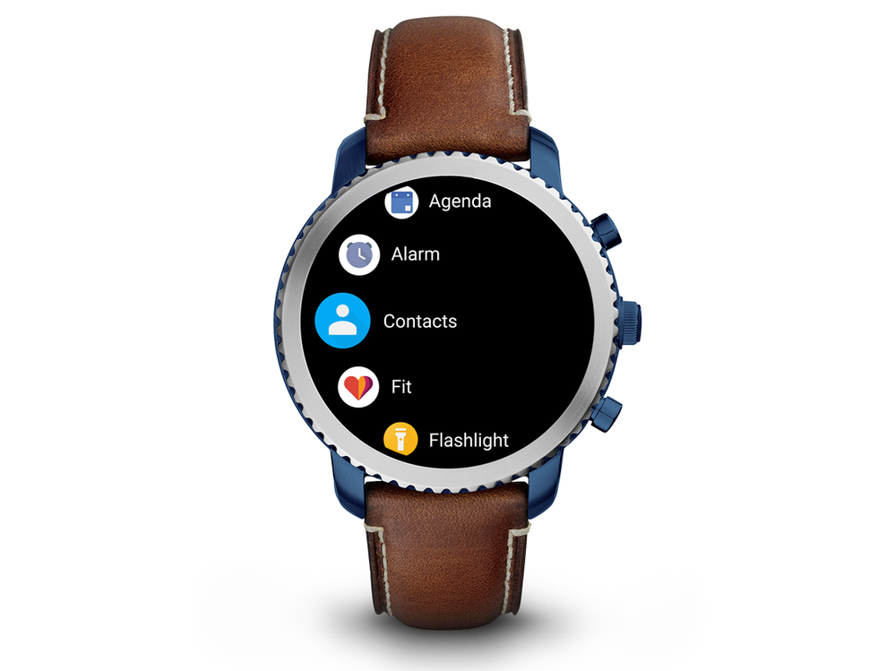

hello Martin....
i want do scrolling but in a arc manner...not vertically means vertically only but some with arc(angle)
thank you
prathima
prathimaAuthor
February 21, 2020
Romain DIELEMAN
February 21, 2020
Hi prathima, what you wish to do in that image is what is done in Tutorial 4 using a scrollWheel and modifying its Y value. You can compare the result and see the code here. Hope this helps,

yeah,,,but is this location y location
y=y + getheight ( )/2-390/2;
your talking about romain Dieleman
Romain DIELEMAN
February 21, 2020
I meant X value my bad. But just do the same code as in the tutorial and you will get this nice arc.
prathima
prathimaAuthor
February 21, 2020
yes ..i got it:) thank you so much...
