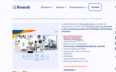

Using Riverdi board:
https://riverdi.com/fr/product/7-inch-lcd-display-stm32h7-frame-rvt70hssfwn00?srsltid=AfmBOor6JTenPNM1U1ScMpNVHtrKVtVqVj-XNgeCxwg_m1t2NYd8tHEm
So yes it can interface 7" 1024×600 LCD with STM32H743ZI.
