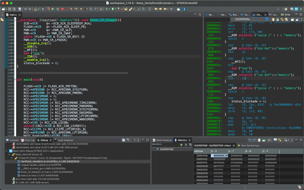

Because it's a Cortex M0 i don't have a lot of Hard Fault information (or do i?). I get the following from the debug window.Bildschirmfoto 2025-08-19 um 22.02.35.png
What says the Fault Analyzer tab next to the Debug tab?
Just „Hard Fault Detected“, nothing else. And the Adress 0x20001fd0 at the bottom right is the one from the MSP. So the Stack Frame is:
  • r0 - 0x20000000
  • r1 - 0x20000004
  • r2 - 0x00000000
  • r3 - 0x00000003
  • r12 - 0x00000003
  • LR - 0x0D000000
  • PC - 0x2000005E --> _ISB();
  • xPSR - 0x01000000 --> Thumb bit
