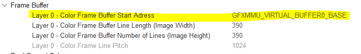

The framebuffer name for the L4R9-EVAL is GFXMMU_VIRTUAL_BUFFER0_BASE. You can find it if you open the ioc file in LTDC -> Layer Settings
I don't think just writing zero to all values will literally turn off the LCD. If you just want to make the screen black, doing it in the Designer is much easier and recommended.
/Alexandre
