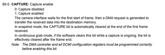

KDJEM.1
The CAPTURE bit is a bit in the DCMI_CR register.
For HAL_DCMI_Start_DMA:
HAL_StatusTypeDef HAL_DCMI_Start_DMA (DCMI_HandleTypeDef * hdcmi, uint32_t DCMI_Mode,
uint32_t pData, uint32_t Length)
With parameters
• hdcmi: pointer to a DCMI_HandleTypeDef structure that contains the configuration information for DCMI.
• DCMI_Mode: DCMI capture mode snapshot or continuous grab.
• pData: The destination memory Buffer address (LCD Frame buffer).
• Length: The length of capture to be transferred.
You can refer to Description of STM32U5 HAL and low-layer drivers for each peripheral driver description.
