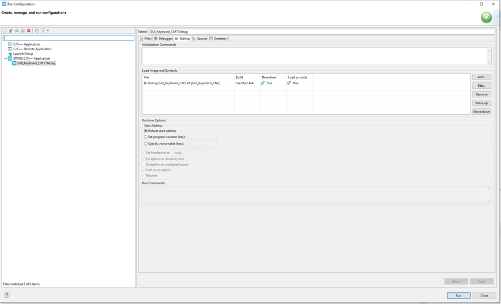

I have created a project on Touchgfx Designer and renamed my project according to:
https://community.st.com/s/idea/0873W000000PAykQAG/detail
so it does not conflict with other project with the same name in my workspace.
I did it successfully and even was able to compile it. I then modified the project via the .ioc file in CubeIDE and was still able to build the project. But Running or debugging the project does NOT work!! I get this famous Error in final launch sequence. This is not the 1st time I got this and an ST employee (@Christophe VRIGNAUD) previously suggested me to revert back to the original project name. That is unfortunately a poor solution and not an option for me as all touchgfx projects bear the same name.
Can anyone help with fixing that ERROR IN FINAL LAUNCH SEQUENCE??
Attached is the log as well.
I tried deleting the current debug configuration and made a new one but the problem is still there.
Solved! Go to Solution.

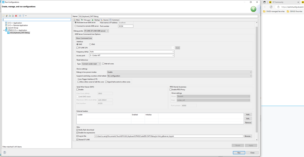

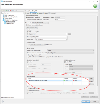

This problem occurs when renaming project files from TouchGFX Designer, to resolve this issue, one must go to the Run Configurations > Debugger > External Loaders and choose the right .stldr file.

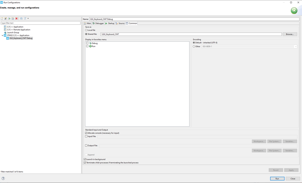

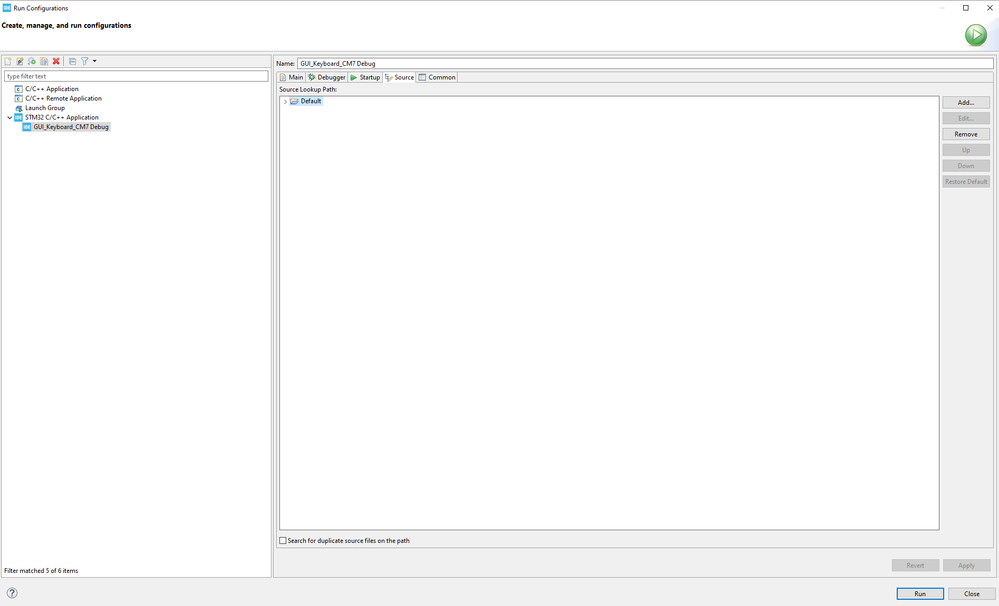

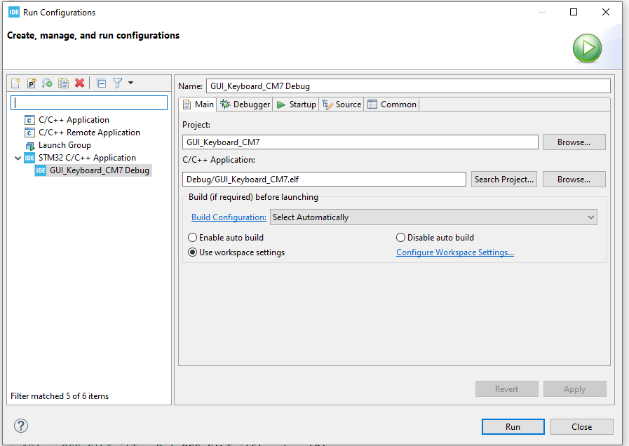

2023-05-12 6:53 AM - edited 2023-11-20 6:39 AM
@Rim LANDOLSI Hi, sorry for the late reply, was busy.
The problem still exists, so would be nice if I can get a proper fix for it.
Here are the debug configs for CM7 as you requested. I don't use CM4 at all.Awaiting your response....
