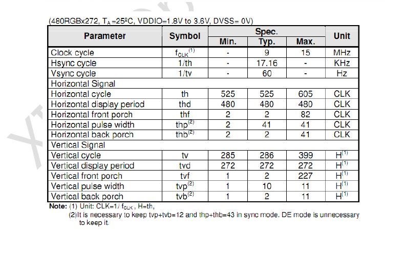

The back porch and front porch are supposed to be on the LCD datasheet. I don't think you can find them elsewhere. It's quite strange that you cannot find these values.
Or else if you have code examples of this screen being used, you can refer to that as the values should be the same.

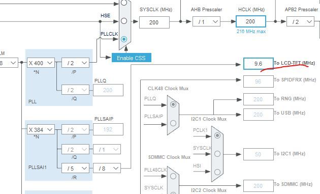

TIM6 is necessary to maintain the stability of the app. This way both the HAL and the OS don't use the same timebase.
TIM6 is for HAL while SysTick is for the OS (here FreeRTOS).
/Alexandre

In datasheet X043DTLT is all polarity and timing porch info on page 9.

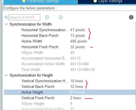

Yes In software I am sending low on R2,B2 lines. Basically I want to saved size of external flash and RAM so choosing RGB565.

I checked page 9, but there data is in CLK(HZ) but I need to mention it in pixels for horizontal and lines for vertical. Can you please help me understand it?
‎2020-07-10 11:55 PM
I looked at the two datasheet and I don't seem to find any relevant info for porch for the 5'' screen 800*480.
On the other hand, like MM..1 mentioned, the screen with a resolution of 480*272px has a table regarding that.
You can see that Horizontal display period = 480 and Vertical display period = 272 which matches the resolution.

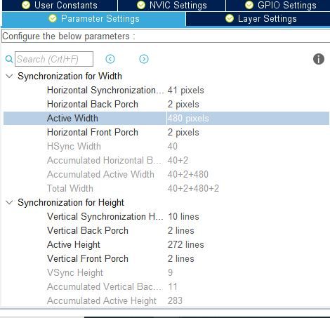

Therefore I guess that :
Horizontal front porch is 2 pixels
Horizontal Back porch is 2 pixels
An same for vertical.
Horizontal Synchronization in CubeMX would correspond to Horizontal pulse width and same for Vertical.
/Alexandre

Thanks @Alexandre RENOUX​ , So you are saying below is correct data for 480*272 ?
My input clock is 9.6 to LCD, but these values ate for 9MHZ.
Also CLK, pixels , lines are same unit?
