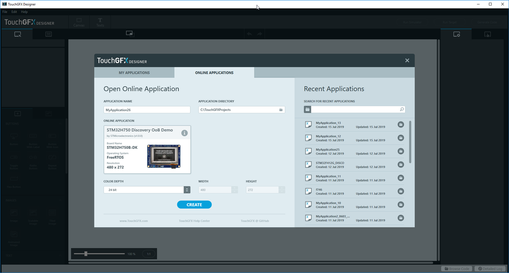

‎2019-07-15 12:40 AM
Hi @scottSD​
We do not have a weblink for the source code for the demo, instead you have to go through the TouchGFX Designer to create an application for the STM32H750 Discovery board.
This is how you do it:
After opening TouchGFX Designer, select the tab called "Online Applications"
Here you will find demo applications which are tied to a specific board, the application you are interested in is called "STM32H750 Discovery OoB Demo"
/Anders
‎2019-07-15 6:14 AM
Thankyou Anders.
Just what I was looking for!
