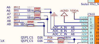

I am using the Nucleo-H753ZI development board (MB1364, STM32H753ZIT6) and have a question regarding the use of pins PF11, PF12, PF13, and PF14 as ADC inputs.
According to the UM2407 User Manual, these pins are stated as not usable for ADC input on this board. However, when reviewing the schematic (MB1364-H753ZI-C01), these pins appear to be free of any conflicting components or functions, and they are shown as connected to ADC-capable channels on the STM32H753ZIT6 (e.g., ADC1_INP2, ADC1_INP6, etc.).

AScha.3
i think its about the Arduino connector, there the PF11..14 are not connected, so cannot be used:

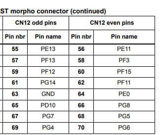

So try using them on connection to CN12 pins :

My question was about the contradiction between  UM2407 User Manual and the Nucleo-H753ZI schematics why those pins are different from the rest ADC input pins?
PF11 is connected to CN12-56.
I am able to configure it as ADC1 INP2. Why these pins are stated as not usable for ADC input on this board in UM2407 User Manual? Also CubeMX allows it.
