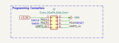

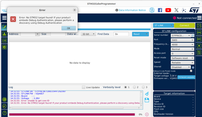

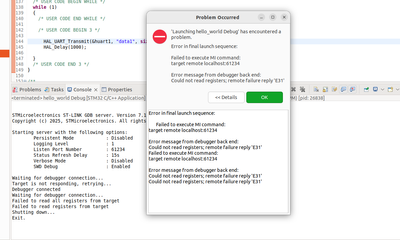

I’m working with the STSPIN32G4. I was able to program the MCU once successfully, but since then neither STM32CubeIDE nor STM32CubeProgrammer are able to detect it anymore.
The main issue is that I did not expose the BOOT0 pin on my board, so I can’t easily force it into system bootloader mode.
Has anyone faced a similar issue?
  • Is there any workaround without physical access to the BOOT0 pin?
  • Would SWD still work if the application firmware misconfigured the debug pins?
  • Any suggestions for recovering the MCU in this situation?

Your firmware probably hangs in a fault handler, or has locked up due to a critical error in a default handler.
As mentioned, you will need the BOOT0 pin.
Perhaps solder a wire contraption with a removable jumper to the pin.
In theory you can try to catch the core with the debugger after power-on reset before it faults, but the probability is close to zero.

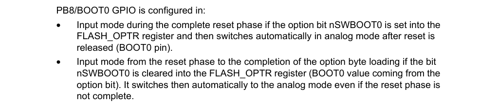

BOOT0  has to be on GND level. No workaround , if used as BOOT0 .
Otherwise try connect under reset (with hardware reset , nrst connected);
then set option bytes ...to not use BOOT0 pin as BOOT0 .
from rm STM32G4 :

I have xonnected boot0 pin to gnd. Now I am able to connect to the MCU using cube programmer, but not able to program it!! Please help
I have attached the log file for reference.
Have you tried a mass erase ?
The Cube programmer should support this.
The option byte and sector erase errors in the log file look strange, although I don't have any experience with the G431.
Now some how I connected my boot-0 pin to GND. Now stm32cube programmer is able to connect to the MCU, but not able to program it. I have attached the log file from stm32 cube programmer. I was also able to download the option bytes of the MCU.
Till now, I was able to program it once after full chip erase using cube programmer. This is very weird behaviour.
