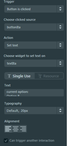

i have this problem, in my app i have a text area which say:
current option:
Option A
using touchGFX i set an interaction when a button is pressed to chage that text area, and i need it to become:
current option:
Option B
when i put those tho line in the text field in the Interaction options on touchGFX like showed

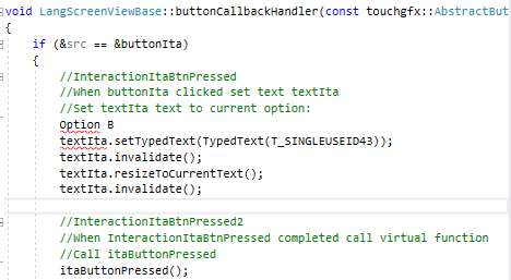

what TouchGFX generates on ScreenViewBase.cpp is this:
and OFC won't compile.
i tryed some escape sequence, but no luck so far...
can someone enlight me.
Thanks in advance

What escape sequences did you try? If not \n or \r\n then try them too.
Zui
Senior
tryed \n, \n\r ,\\n, \0x0A, and whith / instead of \
So what exactly happens with \n for example? I'd think that the generated comment breaking with syntax error should be fixed.

well, with \n there are no errors, but che textArea shown is
current option:\n option B
instead of
current option:
option B
