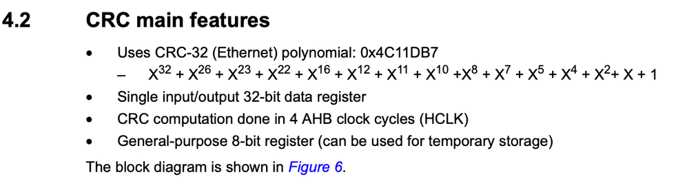

I've been implementing I2C communication between F401CCU6 and Nucleo F746ZG, while adding CRC I got different outputs, Nucleo provides configurable CRC peripheral, while F401 is by default set to 0x4C11DB7 (https://www.st.com/resource/en/reference_manual/rm0368-stm32f401xbc-and-stm32f401xde-advanced-armbased-32bit-mcus-stmicroelectronics.pdf#page=68&zoom=100,89,116)0693W00000QKxkCQAT.pngIt also provides reseting initial value to 0xFFFF FFFF, ("The CRC calculator can be reset to 0xFFFF FFFF with the RESET control bit in the CRC_CR register. This operation does not affect the contents of the CRC_IDR register")
I've set Nucleo CRC polynomial, init value to match those on BlackPill. Calculated value matches with CRC-32/MPEG-2 standard (available at https://crccalc.com/ for example).
In the 'F7 or in the 'F4? As they don't match each other, only one of them may match any "standard".
Probably, data need to be fed byte-wise to achieve this. Or, in words they have to be swapped, as the CRC peripheral is big endian (MSByte-first), unlike the common expectation.

Nucleo spits out 0xBD9AB747 as it should be according to crccalc, the point is, if F4 polynomial is 0x4C11DB7 as stated in manual, and init value was reset to 0xFFFF FFFF accordingly, then why the result is different (0x5355ffb1)?

The HAL_CRC_Calculate() "BufferLength" parameter is NOT the number of BYTES, it is the number of "words". On the F401 the "word" size is fixed at 32bits. On the F7xx it is programmable/configurable to be 8, 16 or 32 bits.
So if you use the code posted above on the F4xx, you are feeding a buffer of 5 bytes but telling it to read 5 each 32-bit words (i.e. 20 bytes).
It expects to be feed 32-bit words, and a word count, doesn't it?
The STM32F4 and several others in the family have a very specific and inflexible implementation, ill suited to the endian ordering at a bit and byte level.
On-line calculators often have difficulty with awkward and specific implementations due to the sensitivity of the CRC's in general to bit level nuances.
