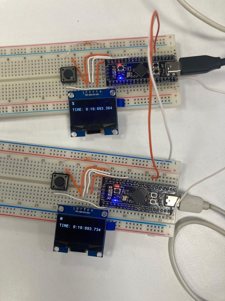

I am working on time synchronization between two identical Blackpill STM32F401CCU6 boards.
Both boards:
  • Use internal HSI oscillator
  • Same firmware
  • Same clock configuration
  • TIM2 configured as 1 MHz free-running counter (1 µs resolution)
  • 32-bit counter (auto-reload = 0xFFFFFFFF)
Clock configuration:
  • HSI ON
  • PLL enabled (HSI → PLL → SYSCLK)
  • SYSCLK = 32 MHz
  • TIM2 prescaler = 31 → 1 MHz timer tick
Initialization
  • Both boards started in STANDALONE mode
  • Both boards waited for button interrupt
  • The board which gets interrupt became MASTER
Synchronization Method
  • One board acts as MASTER
  • Other board acts as SLAVE
  • Communication via UART (115200 baud)
  • Master sends a 5-byte sync packet:
    • 0xAA + 4-byte counter value
  • Slave receives and sets:
    htim2.Instance->CNT = received_counter;
  • UART disabled and connection removed
Initial sync works correctly.
Problem

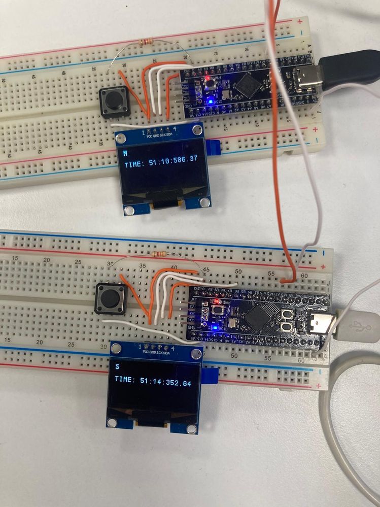

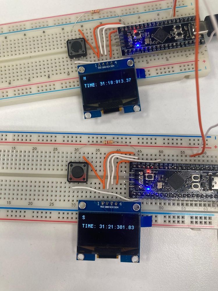

After synchronization:
  • Drift increases over time
  • After 30 minutes → ~2400 ms difference
  • After 50 minutes → ~3200 ms difference
This corresponds to approximately:
~1300 ppm difference between the two boards.
Both boards are identical and running the same firmware.

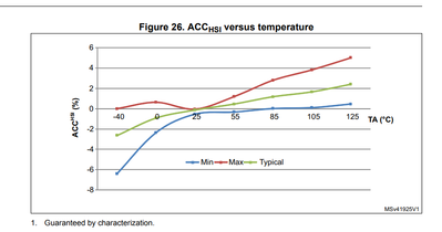

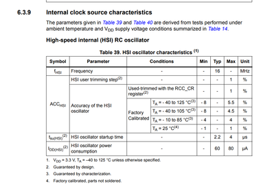

Hello @TTT and welcome to the ST community,
Did you refer to the datasheet?:
This is is for an ST genuine chip (genuine STM32). I'm not sure what you have on that Black Pill board.
Meanwhile, if you are measuring the time in one second precision HSI is not the right clock source. You need to use a crystal and use it with RTC and LSE.
Thank you for your interest,

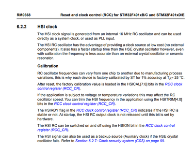

I refer for RM0368 Reference manual STM32F401xB/C and STM32F401xD/E advanced Arm®-based 32-bit MCUs, I can not find your table. I am not sure about the chip is genuine, and here the page of the board:
https://stm32-base.org/boards/STM32F401CCU6-WeAct-Black-Pill-V1.2.html
There are two main documents for a product:
The user manual: mainly for the peripheral and register description. In your case RM0368
The datasheet: manly for the electrical characteristics. In your case DS9716  /Table 39. HSI oscillator characteristics
The errata sheet can also be considered a recommended document to refer to. It provides the limitations in the product as well as some workarounds of these limitations. In your case: ES0222

What's the goal?
You can use a more precise clock source, trim the internal clock, or compensate for error in software.
You can check out application note: AN5067

Here is the goal,
I am dealing with video streaming in some projects, and I need some solution about measuring latency between camera and display. I designed a solution with a single board and works fine but actuator and sensor were wired to it thus I can not done measurements in long distances.
As solution, I thought about 2 identical boards and time sync between somepoint. Then, I will seperated and position them in front of camera and display that are actually far apart from each other.
I am aware that the oscillators may affect from environmental changes such as temperature, humidity, vibration etc., and physical impossibility about manufacturing identical boards, components ...
I am ok with <33.3ms drift for 30fps cameras or <16.7ms for 60fps ones. But I need a few hours for sync, transport and measure the latency, so I need maximum 10-30 ppm.
