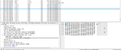

The data packets are monitored on the Wireshark , below is the screenshot
It seems that the PC is requesting the data , but the device never responds with the packet because the DATAIN is not called.

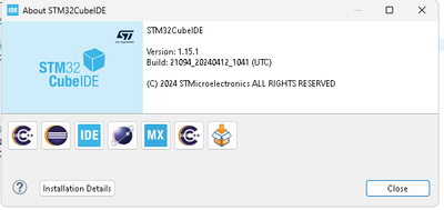

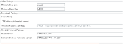

I am using STM32CubeIDE version 1.51.1
The firmware version for STM32F401CCU6 firmware version is V1.28.0
