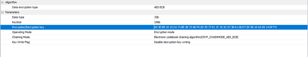

Something is completly wrong somewhere. I have been doing steps in different location and going to the basics but it is still not working.
I activated the AES HW aceleration module to do the encryption/decryption there. I did not get CCM working but going even further I tried to replicate the example on the STM video tutorial on youtube:
Security Part3 - STM32 Security features - 25 - AES CRYPT lab (I cannot add the link directly).
This video tries to replicate one of the examples of the ECB encryption/decryption of the standard NIST Special Publication 800-38A. I am trying to replicate exactly the same example.
The function HAL_CRYP_Encrypt used in this video is not available in the version of the HAL drivers I am using (V.1.21.0) but i tried using the functions HAL_CRYP_AESECB_Encrypt and HAL_CRYPEx_AES. I even tried using the 32bits and the 8 bits configuration posibilities but none of them gave the expected result:

I am starting to think that something it mad in my MCU or in the drivers. Can please someone support!?
Best regards
PS: As commented before using the MBEDTLS SW I got it working straight forward. Regretfully this is too slow for my application. Any advice would be greatly wellcome.
