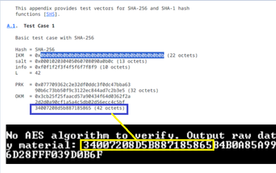

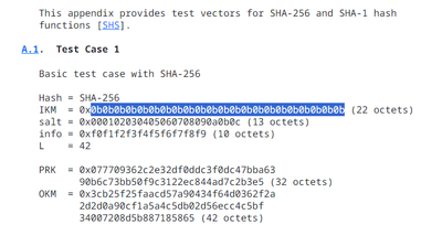

I am taking the reference implementation of the HKDF Algorithm using PSA API in the TFM Application Project and using the following algorithm :
PSA_ALG_HKDF(PSA_ALG_SHA_256);
I m able to export the output key to the console and am getting an output for the test vectors taken from RFC5869 as shown below:
But when using the same Hash, IKM, Salt, Info as given in the test vector set Im getting a different value as shown in the below format:(value displayed Derived Key Material is expected to be same as OKM in above Figure)
The codes i have used the same format that was already present to be specific:

Hi @PJose.4
I can see that the first digits of your outputs are the same as the OKM last digits
What is the status returned by the psa_key_derivation_test() API, did you see any of the output failing messages
"Failed to input salt " or " .... key" or ".... Info"
Can you give more details, how you configured the RFC5869 test vector before calling psa_key_derivation_test() ?
