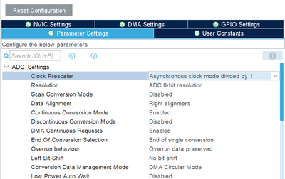

I'm using ADC_3 with 8-bit resolution, trying to measure an analog sine wave of 1 kHz as a stimulus.

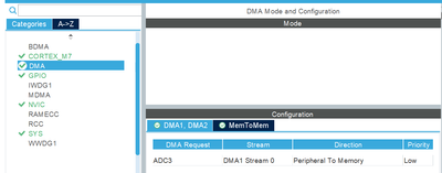

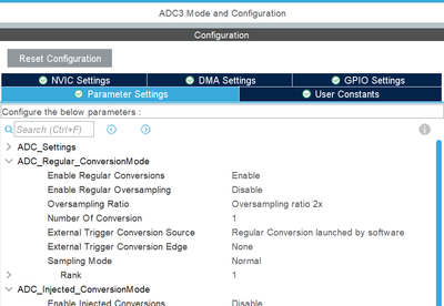

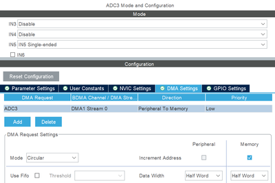

I'm trying to use the ADC with DMA. However, I am unable to get any values other than zero. I have tested it in polling mode and have successfully gotten correct values. I have been looking at multiple code examples. It seems like HAL_ADC_START_DMA should be enough to start sampling; however, my buffer isn't being updated. Where have I gone wrong?
DMA settings
ADC DMA settings
ADC_settings
ADC_regular_conversionMode
CODE:

Ended up using the linker script to set of some memory. This solved the problem. look here https://controllerstech.com/stm32-adc-multiple-channels-circular-dma/
2025-06-20 5:13 PM
You need to calibrate the ADC before starting the DMA
HAL_ADCEx_Calibration_Start(&hadc3, ADC_CALIB_OFFSET /* or ADC_CALIB_OFFSET_LINEARITY*/ , ADC_SINGLE_ENDED);
2025-06-21 1:33 AM
@_summer_intern_ wrote:CODE:
/* USER CODE BEGIN 2 */
HAL_ADC_Start_DMA(&hadc3,&adc_val, 2);
/* USER CODE END 2 */
/* Infinite loop */
/* USER CODE BEGIN WHILE */
while (1)
/* USER CODE END WHILE */
/* USER CODE BEGIN 3 */
snprintf(adc_buff, 4,"%d",adc_val);
adc_buff[3] = '\n';
HAL_UART_Transmit(&huart3, adc_buff, 4,HAL_MAX_DELAY);
HAL_Delay(1000);
}You start the ADC+DMA, and then immediately print the results.
You need to wait for the ADC acquisition and DMA transfer to complete before the results will be available!
Also, adc_val will need to be volatile.

Hello @_summer_intern_
Please refer to the example below:
2025-06-23 1:55 AM
Correct. Which suggests the OP does not yet really grasp the idea of DMA, and how it works.
And this compelled me to take a look at the source code - despite the fact that Cube code hurts my eyes ...
But there is a DMA interrupt configured, but no respective callback (assuming no modifications of the default interrupt handler).
I assume this is the TC interrupt, which would be the right time to process the ADC input.
On a related note ...
If I do such a thing (continuous printing out ADC results via UART), I check before that the output bandwith exceeds the input bandwitdh. I am not sure such a check happened here.

I missed it earlier but I see that you have Continuous Conversion Mode enabled. In previous projects, I observed that this will cause interrupts continuously to the point the ADC can't do a conversion correctly.
So I did a test again and I was able to replicate your issue with ADC1 with Continuous Conversion Mode enabled. It was reporting 0, as you've indicated.
To fix it do this. I created a 100ms interrupt timer to trigger the ADC conversion.
1. In ADC, disable Continuous Conversion Mode
2. Enable a timer like Timer15.
3. Now in ADC, set External Trigger Conversion Source to Timer 15, Trigger Out Event
int main(void)
// other HAL code
uint16_t adc_val;
char str[16];
HAL_ADCEx_Calibration_Start(&hadc1);
HAL_ADC_Start_DMA(&hadc1,(uint32_t*)&adc_val, 1); // only 1 conversion/rank
HAL_TIM_Base_Start_IT(&htim15); // set for 100ms interrupts
/* Infinite loop */
while (1)
HAL_Delay(1000); // allow for first conversion to complete
sprintf(str, "%d\n", adc_val);
HAL_UART_Transmit(&huart2, (uint8_t*)str, strlen(str), 100);
/* USER CODE END 3 */
2025-06-23 10:34 PM
I missed that, too.
Probably because the idea doesn't make too much sense in the first place - continuous single-channel conversion with DMA.
The "old" SPL examples mostly used continuous conversion, pushed the value in a buffer variable, and the main loop read at irregular intervals.
An approved method that works quite well.
I don't know the H7 variant, but most F0...F7 ADCs have options to trigger an ADC conversion from a timer directly, in the ADC peripheral config register. The exact timer device depends on the variant.
DMA, at least for a real application, makes sense for multiple channels.
In this case, the DMA TC interrupt would be the place to pick up the results.
