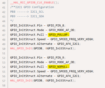

I have been trying to configure Nucleo STM32F401RE board as an I2C Slave and Xavier Nx as Master but it is throwing me BUSERR.
I am adding some the main.c file below to explain my configuration

__HAL_RCC_GPIOB_CLK_ENABLE();
/**I2C1 GPIO Configuration
PB8 ------> I2C1_SCL
PB9 ------> I2C1_SDA
GPIO_InitStruct.Pin = GPIO_PIN_8;
GPIO_InitStruct.Mode = GPIO_MODE_AF_OD;
GPIO_InitStruct.Pull = GPIO_PULLUP;
GPIO_InitStruct.Speed = GPIO_SPEED_FREQ_VERY_HIGH;
GPIO_InitStruct.Alternate = GPIO_AF4_I2C1;
HAL_GPIO_Init(GPIOB, &GPIO_InitStruct);
GPIO_InitStruct.Pin = GPIO_PIN_9;

What am I doing wrong to get a BUSERR
2 REPLIES 2
Hl_st
can you also share a hardware connection? Are there connected external pull up resistors?
Karl Yamashita
Principal
It looks like you have internal pull-up enabled for SCL, but not for SDA. Hopefully you're not relying on internal pull-ups and that you indeed have external pull-ups. If not, use 2 resistors on both SCL and SDA. ~4.7K is typical value to start with.
