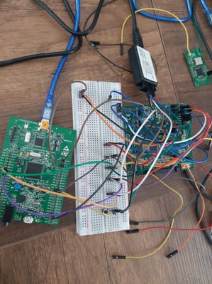

How is it wired? Show pictures. MISO at 0xFF or 0x00 generally indicates wiring is not as expected, or pins are already in use, or some other setup issue.
 I am connecting pins using a breadboard. I tested the pins with a short circuit test all of them are connected. I am supplying AVDD and DVDD with 3V. Thanks for your reply @TDK
What pin is used for MISO? Is it in use by something else on the STM32F407G-DISC1 board? If you set that pin to output push/pull and disconnect from the ADS chip, can you toggle it and observe on the scope?
If you connect MOSI to MISO, do you read back the same data you're sending out?
I am using PA6 as a MISO pin. The configuration for the MISO,MOSI and SCK
is the default configs for the SPI. I tried readback operation and I can
see same message that I sent. Did you see any misconfigutation in the code?
No, I don't see any misconfiguration in what is presented. I suspect it's a hardware issue, not software. STM32 seems to be doing its job.
Hello @Omerbzkt
Please use a short cable with wire wrapping to connect your device

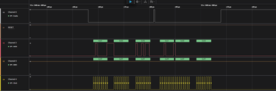

I made some adjustments to my code, and now I can see certain values. However, when I attempted to read the register value, it changed every time. I did not understand which part was problematic. This is my latest code. As far as I understand, the timing of the SPI communication between ADS1299 is critical. Is there any suggestion for fixing this misreading? According to the datasheet, when the reset operation finishes, I have to see the 0x3E value in the register.

#include "main.h"
/* USER CODE END Includes */
/* USER CODE BEGIN PTD */
#define COMMAND_RESET  (0x06)
#define COMMAND_SDATAC (0x11)
/* USER CODE END PTD */
/* USER CODE BEGIN PD */
/* USER CODE END PD */
/* USER CODE BEGIN PM */
/* USER CODE END PM */
SPI_HandleTypeDef hspi1;
/* USER CODE BEGIN PV */
/* USER CODE END PV */
static void MX_SPI1_Init(void);
void ADS1299_init(void);
void ADS1299_send_cmd(uint8_t command);
uint8_t ADS1299_read_reg(uint8_t address);
/* USER CODE BEGIN PFP */
/* USER CODE END PFP */
/* USER CODE BEGIN 0 */
/* USER CODE END 0 */
  * @brief  The application entry point.
  * @retval int
int main(void)
  /* USER CODE BEGIN 1 */
  /* USER CODE END 1 */
  HAL_Init();
  /* USER CODE BEGIN Init */
  /* USER CODE END Init */
  SystemClock_Config();
  /* USER CODE BEGIN SysInit */
  /* USER CODE END SysInit */
  MX_GPIO_Init();
  MX_SPI1_Init();
  /* USER CODE BEGIN 2 */
  ADS1299_init();
  ADS1299_send_cmd(COMMAND_RESET);
  HAL_Delay(10);
  ADS1299_send_cmd(COMMAND_SDATAC);
  /* USER CODE END 2 */
  uint8_t id_reg = 0;
  uint8_t counter = 0;
  /* Infinite loop */
  /* USER CODE BEGIN WHILE */
  while (1)
    /* USER CODE END WHILE */
	  id_reg = ADS1299_read_reg(0x00);
	  if(id_reg == 0x3E)
		  counter += counter;
	  else
		  HAL_Delay(2000);
    /* USER CODE BEGIN 3 */
  /* USER CODE END 3 */
	HAL_GPIO_WritePin(PWDN_GPIO_Port, PWDN_Pin, GPIO_PIN_SET);
	HAL_Delay(150);
	HAL_GPIO_WritePin(RESET_GPIO_Port, RESET_Pin, GPIO_PIN_RESET);
	HAL_Delay(1000);
	HAL_GPIO_WritePin(RESET_GPIO_Port, RESET_Pin, GPIO_PIN_SET);
	HAL_Delay(20);
	HAL_Delay(20);
	HAL_GPIO_WritePin(CS_GPIO_Port, CS_Pin, GPIO_PIN_RESET);
	HAL_SPI_Transmit(&hspi1, &command, 1, 1000);
	HAL_GPIO_WritePin(CS_GPIO_Port, CS_Pin, GPIO_PIN_SET);
	HAL_Delay(10);
    uint8_t tx_data[3] = {0x20 | address, 0x00,0x00}; // RREG, 1 register, dummy byte
    uint8_t rx_data[3] = {0};
    HAL_SPI_TransmitReceive(&hspi1, tx_data, rx_data, 3, 1000);
    return rx_data[2]; // Register value is in the third byte
  * @retval None
void SystemClock_Config(void)
  __HAL_RCC_PWR_CLK_ENABLE();
  __HAL_PWR_VOLTAGESCALING_CONFIG(PWR_REGULATOR_VOLTAGE_SCALE1);
  RCC_OscInitStruct.OscillatorType = RCC_OSCILLATORTYPE_HSI;
  RCC_OscInitStruct.PLL.PLLSource = RCC_PLLSOURCE_HSI;
  RCC_OscInitStruct.PLL.PLLM = 8;
  RCC_OscInitStruct.PLL.PLLN = 50;
  RCC_OscInitStruct.PLL.PLLP = RCC_PLLP_DIV4;
  RCC_OscInitStruct.PLL.PLLQ = 7;
    Error_Handler();
  RCC_ClkInitStruct.APB1CLKDivider = RCC_HCLK_DIV4;
  RCC_ClkInitStruct.APB2CLKDivider = RCC_HCLK_DIV2;
  if (HAL_RCC_ClockConfig(&RCC_ClkInitStruct, FLASH_LATENCY_0) != HAL_OK)
    Error_Handler();
  * @brief SPI1 Initialization Function
  * @PAram None
  * @retval None
  /* USER CODE BEGIN SPI1_Init 0 */
  /* USER CODE END SPI1_Init 0 */
  /* USER CODE BEGIN SPI1_Init 1 */
  /* USER CODE END SPI1_Init 1 */
  /* SPI1 parameter configuration*/
  hspi1.Instance = SPI1;
  hspi1.Init.Mode = SPI_MODE_MASTER;
  hspi1.Init.Direction = SPI_DIRECTION_2LINES;
  hspi1.Init.DataSize = SPI_DATASIZE_8BIT;
  hspi1.Init.CLKPolarity = SPI_POLARITY_LOW;
  hspi1.Init.CLKPhase = SPI_PHASE_2EDGE;
  hspi1.Init.NSS = SPI_NSS_SOFT;
  hspi1.Init.BaudRatePrescaler = SPI_BAUDRATEPRESCALER_4;
  hspi1.Init.FirstBit = SPI_FIRSTBIT_MSB;
  hspi1.Init.TIMode = SPI_TIMODE_DISABLE;
  hspi1.Init.CRCCalculation = SPI_CRCCALCULATION_DISABLE;
  hspi1.Init.CRCPolynomial = 10;
  if (HAL_SPI_Init(&hspi1) != HAL_OK)
