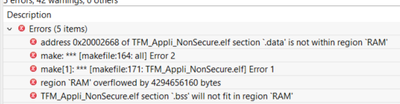

Hello, I am using STM32U585 TFM architecture for one of my project. Which basically is a combined project of 5 internal projects as usual TFM(mentioned below).
1. TFM_Appli_NonSecure
2. TFM_Appli_Secure
3. TFM_Loader_NonSecure
4. TFM_Loader_Secure
5. TFM_SBSFU_Boot
I have surpassed available RAM(SRAM1 of 192kb) for TFM_Appli_NonSecure project. And I am not getting any solution to this even after trying some ways like using SRAM3(mainly).
I think now I need some export opinion for increasing this availablity by minimum of 50kb
Any support any support will be appreciated.
Thanks,
Nitin
Solved! Go to Solution.

‎2024-04-30 12:53 AM
Hello Nitin,
You can use part of SRAM3 of STM32U5.
TFM uses SRAM2 and first 32K of SRAM3 as you can see in region_defs.h
#if defined(STM32U535xx) || defined(STM32U545xx)
#define S_TOTAL_RAM_SIZE (_SRAM2_SIZE_MAX) /*! size require for Secure part */
#else
#define SRAM3_S_SIZE 0x8000 /* 32Kbytes */
#define S_TOTAL_RAM_SIZE (_SRAM2_SIZE_MAX + SRAM3_S_SIZE ) /*! size require for Secure part */
#endif /* defined(STM32U535xx) || defined(STM32U545xx) */
So, you can add a region in your non secure linker file starting from SRAM start + 32K until SRAM end.
Then you will need to allocate part of your data in this area
Best regards
Jocelyn

‎2024-04-30 1:53 AM
Hi Jocelyn, thanks for quick support.
I have tried changing MEMORY region like below.
MEMORY
FLASH (rx) : ORIGIN = NS_CODE_START, LENGTH = NS_CODE_SIZE
RAM (rwx) : ORIGIN = _SRAM3_BASE_NS + 0x8400, LENGTH = 0X3C800
/*RAM (rwx) : ORIGIN = NS_DATA_START, LENGTH = NS_DATA_SIZE*/
And I have got compilation error as,
If it is because I have not performed "you will need to allocate..
part of your data in this area" I have to try this as I am not expert in LD files.
If issue is something else kindly advice me.
Thanks in advance.
‎2024-04-30 2:43 AM
Hi Jose, by getting some understanding of linker script I made it work. Thanks to your guidance in above reply. You are amazing as always:)
