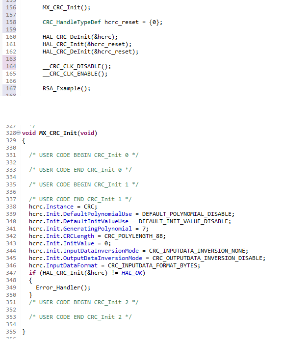

I have the same problem by using the lib "STM32CubeExpansion_Crypto_V3.1.0" with a STM32L476.
I'm using the exemple on the folder "Enc_Dec" and I got a problem:
 I use CRC calculation for another calculation and I didn't find the way to properly DeInit the CRC. If I call the function MX_CRC_Init(); generated by CubeMX, I can't use RSA encryption, the output message is wrong. I try several way to reset the CRC by nothing works.
How can I use CRC properly ?
Thanks in advance for help.
Dams
Jocelyn RICARD
Hello Dams,
I'm sorry for this late answer.
The default CRC configuration after reset is working fine.
So, I would advise just resetting the CRC IP.
Best regards
Jocelyn
