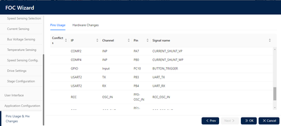

Hello @Rescuedan,
For "generated from an empty directory," ensure that you do not use a directory where an MCSDK project has already been created.
Once a project is created, the full pin usage description is available in the following tab:
Refer to Electronic Speed Controller user manual for more detail.

Hello @Rescuedan,
Did you review the Motor Profiler application note available through Workbench tool > About > Documentations > Documentation > User manual?
The MCSDK project must be generated from the Workbench tool and from an empty directory. It appears that your second firmware generation attempt was performed using the STM32CubeMX tool.
Although it is not currently documented (this will be added in future documentation updates), avoid using the Stage Configuration/ESC feature and the Application Configuration/Motor Profiler simultaneously.

Hello @Rescuedan,
