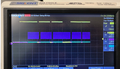

I have a custom PCB with H7R3Z8T6 & MX25L12833F (16MB Marconix NOR-Flash) hooked up with XSPI1 (Quad SPI). I have been having a very difficult time programming the external memory with the External Loader in CubeIDE.
I have followed a forum post (https://community.st.com/t5/stm32-mcus/how-to-create-an-external-flash-loader-for-an-stm32h7rs/ta-p/742005) as a guide to getting started (also https://www.st.com/content/st_com/en/support/learning/stm32-education/stm32-moocs/external_QSPI_loader.html). The only real difference between the guide and my project is I am powering the memory with 3.3V and therefore did not enable HSLV option byte.
My issue is that when I flash the Appli firmware, it fails to verify: (Data mismatch found at address 0x90000002 (byte = 0x00 instead of 0x01). When I read the 0x9... register in CubeProgrammer, it is all zeros until ~0x9003XXXX, after which 0xFFFFFFFF is read (see screenshot below). The extact register where 0xFFFFFF03 is read varies, it changes every time I re-read the memory.

What is the frequency of xspi?
Can you specify which curves you are observing on the oscilloscope?

Hi Kaouthar,
Thanks for your information!
The XSPI in this screenshot is running at 133MHz (max for the memory) but I had previously already tried running at lower speeds with little success.

Have you checked the dummy cycle and chip select high time required based on frequency used?
-but I had previously already tried running at lower speeds with little success.
Is the HSLV enabled?
I recommend you to refer to table 74, table 75, table 76 and table 77 in the datasheet and check the maximum frequency allowed for low speeds "00".
