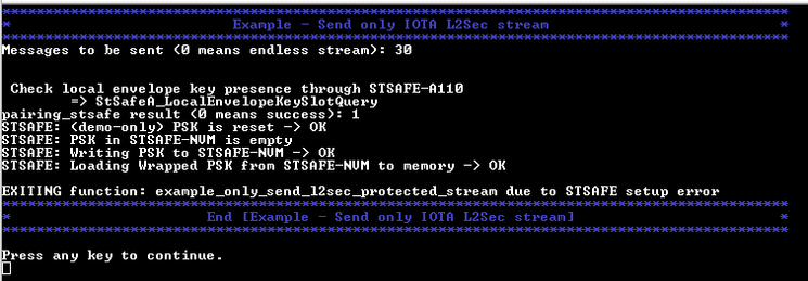

I'm trying to run the X-CUBE-IOTA1 v3.0 on the B-U585I-IOT02A board, but after following the tutorial in UM2606 I get the following error when trying to send L2Sec Stream:
What can be the reason of the pairing_stsafe result failing, please?

‎2024-02-08 7:26 AM
Hi @SedCore,
I think this issue is related the change of the STSAFE-A power management on B-U585-IOT2A board.
The error reported (1) is STSAFEA_COMMUNICATION_ERROR which generally occurs on the first STSAFE-A commands when the STSAFE-A is not responding on the I2C.
According to the User Manual of the B-U585-IOT2A board, the PF11 pin shall be 0 to enable the STSAFE-A.
In the X-CUBE-IOTA v3.0.0 x-cube-iota1/Projects/B-U585I-IOT02A/Applications/IOTA-Client/NetXDuo/App/STSAFE/stsafea_service_interface.c
in the HW_IO_Init, you have this line which set the PF11 to 1 :
HAL_GPIO_WritePin(STSAFEA_VREG_GPIO_PORT, STSAFEA_VREG_PIN, GPIO_PIN_SET);
Therefore, this disabled the STSAFE-A.
if you replace the line by HAL_GPIO_WritePin(STSAFEA_VREG_GPIO_PORT, STSAFEA_VREG_PIN, GPIO_PIN_RESET);
It should enable the STSAFE-A and you should be able to run the test code.

‎2024-02-08 9:01 AM - edited ‎2024-02-09 1:53 AM
Thanks for your advice, now the encryption using STSAFE is working well. :thumbs_up::thumbs_up:
But unfortunately, the message is not being sent, due to a DNS error when trying to connect to the Tangle network at this address: https://api.lb-0.h.chrysalis-devnet.iota.cafe
There is no public network running the Chrysalis protocol anymore, so the X-CUBE-IOTA1 package should be updated.
