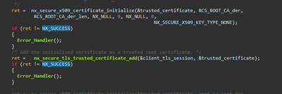

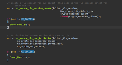

 am using the APIs as mentioned in the documentation
adding root ca certificate for the verification
