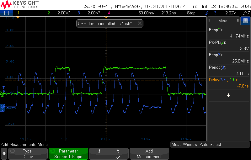

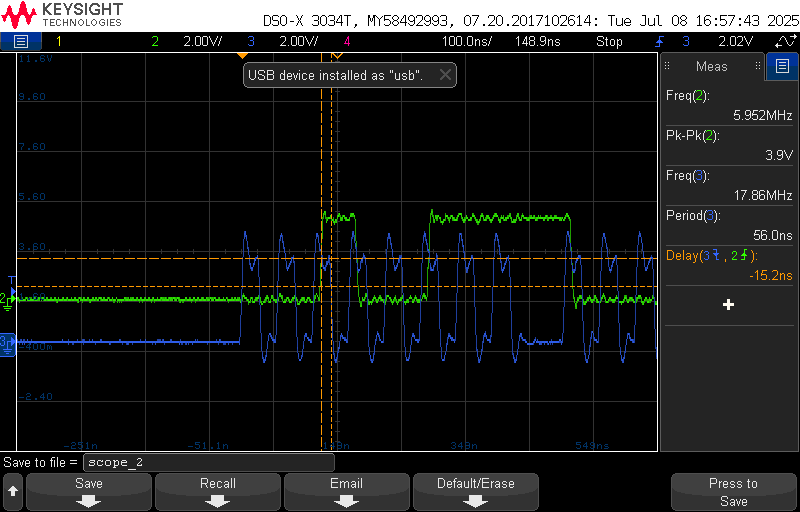

I tested with shorter (2-3cm) and longer wires (20cm) the bit shifting still continues. One important thing that I noticed as I increase clock speed from 18 MHz to 25 MHz the delay between the rising edge of MISO and SCK decreases from 15.2 ns to 7.8ns. I am operating in SPI mode 01. I wander if that's the problem which leads to bit shifting. How to resolve it?

At 25 MHz: Green is MISO and blue is SCKAt 25 MHz: Green is MISO and blue is SCK
At 18 MHz: Green is MISO and blue is SCKAt 18 MHz: Green is MISO and blue is SCK
At 25 MHz I see bit shift while for 18 MHz the data is received correct. In the image: green signal is MISO and blue is SCK
Lots of overshoot/ringing on blue but none on green. Signals are also not synchronized. The rising edge of blue should line up with edges in green, but it's not. Green is lagging, and lags more with higher clocks. Don't really know why, but that's likely part of the issue. These are faults of the master SPI.
