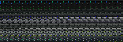

I have an issue to understand the MCU blocks for JPEG encoder. I have an stm32h743 MCU which is connected to a video decoder with dcmi interface. In ram I have the captured 8-bit ITU-R BT.656 YCrCb 4:2:2 output. Saving the captured data from ram to a debug file, I can see the image is captured properly. The byte stream looks like: Cb0-1, Y0,Cr0-1, Y1, Cb2-3, Y2, CR2-3, Y3 .... total 720Y and 360CB and 360 CR, total 1440 bytes + 8 byte blanking per line. And I have 240 lines so the resolution that I am capturing is 720x240.
As described in the AN4996, each 4:2:2 MCU contains 256 bytes organized as two 8×8 Y blocks plus one 8×8 Cb block plus one 8×8 Cr block. For a 720×240 image, I should need 45 horizontal MCUs × 30 vertical MCUs = 1,350 total MCUs. My confusion is the two Y blocks. I implemented the two Y blocks as:

With this code, I got this jpeg image:
The file header, resolution looks okay, but the content is corrupted. And I am not sure why.
Any idea?
rob-bits
I found a solution. Basically my implementation was correct. The example code brings too much complexity, it is not easy to integrate... Anyway, the issue that I was facing is related to cache issue with dma. I had to clean the dchache each time I created an MCU block. Something like this:
