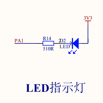

I have stm32407vg and the LED is on the 'PA1' and I need that the LED turned 'On' after command witch It should turn it 'ON'. In may case after line № 18.
But 'LED' turns 'ON' after line №16 and turns 'OFF' after line № 18
Could you tell me why it happens?

waclawek.jan
Is the LED connected cathode to PA1 and anode through resistor to VCC?

How can I find out it?
Here is a link to my stm32f407vg https://stm32-base.org/boards/STM32F407VGT6-STM32F4XX-M.html#User-LED

PA1 needs to be low in order to turn on the LED.
