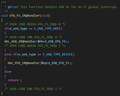

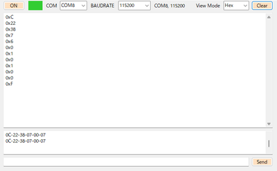

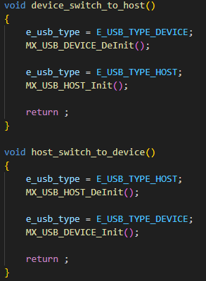

Hello @FBL,
Thank you for your sharing! Below is my current configuration:
Our project is currently using the USB host feature, and my task is to add USB device support.
To ensure compatibility with MX, we added our code within the USER CODE sections and enabled HAL_PCD_MODULE_ENABLED via CubeIDE.
We also added two functions to switch between HOST and DEVICE modes.
For USB CDC testing, I created a simple tool to send data over UART and verify the received data, and in my opinion, it works properly.
Additionally, we found that my personal computer (running Windows 10) can correctly recognize the USB CDC device. This makes the situation even more confusing, as I haven’t installed any STM32-related software on that machine.
