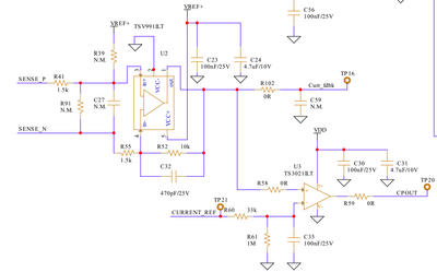

I'm learning BLDC control using the EVSPIN32G06Q1S1 and MCSDK 6.4.
The inner current loop is implemented in hardware.
The current feedback goes to an op-amp PI controller (I think?),
then is compared with a reference voltage.
The reference voltage level depends on the TIM17 PWM duty cycle.
The comparison result goes to TIM1 ETR.
There is no documentation for this.
I need a manual or design guide for selecting the capacitor and resistor values in the PI controller.

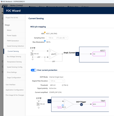

Full MCSDK documentation is available through Workbench tool > About > Documentations > Documentation.
Current sensing is described in the User ManualCurrent sampling chapter.
Refer to stspin32g0601 datasheet documentation for system-in-package description.
Workbench tool also provides feature descriptions: external amplification is described in the schematic. For overcurrent protection, the internal comparator is used, so the CPOUT signal is not used.
This circuit is on the EVSPIN32G06Q1S1 board,
not an STSPIN32G0601 function, and not a software function.
I cannot find any chapter about this circuit in STSPIN32G0601 datasheet or in MCSDK documentation.
Please check.

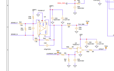

Let me organize the information I found and the questions I need to confirm:

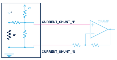

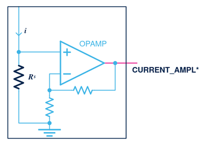

  1. From this wiki page,
    I found a current-sensing op amp design that looks almost the same as the EVSPIN32G06Q1S1, but without the capacitor.
    Is this the current-sensing method used by EVSPIN32G06Q1S1 in 6-step mode?

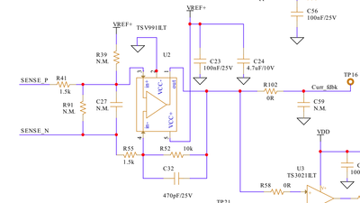

  2. Following point 1 —
    in FOC mode, the EVSPIN32G06Q1S1 needs R91 and R39.
    But in the wiki's single-shunt examples, I don't see this design.
    Instead, it looks more like this 3-shunt version .
    Are these two resistors for offset? Or do they do something else?

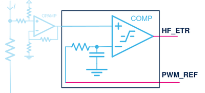

  3. From this wiki section,
    I see a current loop design that looks almost the same as the EVSPIN32G06Q1S1.
    Is this the current loop used by EVSPIN32G06Q1S1 in 6-step mode?

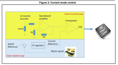

  4. In UM2124, I found a current loop design that looks almost the same as the EVSPIN32G06Q1S1.

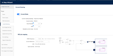

You are referring to the "current mode" drive of the 6-step algorithm. The relevant information about this drive mode is available in the MCSDK 6.4.1 Workbench, under the "current sensing" section.FabriceLOUBEYRE_0-1755097077832.png
This implementation follows the same principles referenced in UM2124, section 3.3.1, Current mode control.

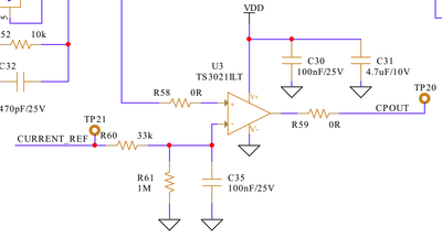

The "shunt current" coming from phases after amplification is compared to a "current reference" generated by the MCU trough a general purpose PWM Timer. As soon as the motor current reaches the "current reference" threshold, the ETR input turns PWM signals off of the Advanced-control timer.
The shunt value and the AOP gain (resistor bridge) must be designed to match the comparison.
The speed PID will deal with the "Current reference" duty cycle. The KP will control  the stability of the speed, and the KI more the speed variation during a change of speed

1. Yes, to perform current sensing, you need a shunt resistor (Rs) that is defined based on the current. The boards provide an Rs for a range of currents, which is not optimal. It should have a low resistance to minimize power loss and voltage drop but be high enough to produce a measurable voltage. This voltage is then amplified to enable comparison.
1. Yes, they are placed for offset purposes, in cases where the voltage across a low-value shunt resistor is very small or when DC offset or noise in the measurement chain significantly distorts the current measurement.
3. Yes, this is the comparison between the shunt current and the current reference.
4. Yes, it is.
5. The Rs and AOP gain are designed to match the maximum current of the board. If you have a motor with a lower current, you need to change either Rs or AOP gain to match your requirements.
