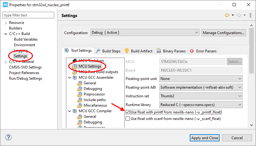

I have some problems with printf function.
For example,
float valf=0;
printf("%.0f",valf)
The result is
f
I don't understand...I thought that the native printf worked...
The option
Use float with printf is flagged.
Thank you.

Do you enabled float output in CubeIDE?
Make sure you've provided suitable plumbing code to a UART you have configured and enabled.
I​n STs GNU/GCC implementation via __io_putchar and called from write()

If I write, for example,
printf("TEST %.0f",valf)
the result is
TEST f
if I put the breakpoint in my uart function, the string pointed is "TEST f"
I have no problems with integer...
this for example works correctly
TRACE(("ENDLOG%.2d%.2d%.2d%.2d%.2d%.2d.%d",g_DATEDAY,g_DATEMONTH,g_DATEYEAR,g_TIMEHOURS,g_TIMEMINUTES,g_TIMESECONDS,g_TIMEmSECONDS));
the result is:
ENDLOG010323142500.1

In your IDE, compiler configuration, check icon "nano printf" for float variables.
ONadr.1
Senior III
IVent.1
Senior
Attached my compiler configuration.
