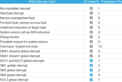

Hello @TDK and @Ozone ,
To answer your questions, yes ADC and DMA interrupts are enabled. Before the main while loop of my code I call all of the regular inits but then also the following functions for TIM1 and TIM3, and ADC1 and ADC3 respectively. The ADCs are configured to trigger off Timer 1 TRGO, which is set to OC1REF, I had no issues with this setup on my nucleo.
HAL_TIM_Base_Start_IT()
HAL_ADC_Start_DMA()
 Attached is an image of my NVIC setup in cubeMX , I realised earlier that the priorities were all 0 and thought that may be causing issues so changed the system to what is depicted below, this did not fix it though.
The only change I can think of between the two implementations is that I have more values being read on a single dma stream (up to 8).
I am a bit confused as to what to try next, @Ozone I'm not quite sure what you mean by placing it in the interrupt handler instead, I'm not sure where that would be.
I don't see any issues with the code or screenshots you've presented. I suspect the issue is elsewhere. Systick priority should probably be higher but I don't think that's the main issue.
