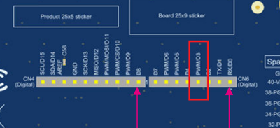

For some reason my MCO(PA8) only outputting 8MHz despite me configuring it for 60MHz
I am completely baffled because I have followed all the correct register settings(as far as I am aware) for the clock configuration, and have followed the clock diagram from the stm32cubeide

I've generated a project based on your ioc file and tested it and I can see 60Mhz on PA8
And the IOC file does, indeed, have MCO configured as 60MHz:
So back to @KnarfB's suggestion that the problem is with your measurement

Does your LA have enough sample frequency or do you see an alias frequency?
My MCO is configured to PA8, and I'm using it to test my MCO
strangely, the code from the ioc is giivng me no results, wheras the one I wrote bare metal gives me an actual value(50MHz for now, but I can configure it!!)

That doesn't make sense .. did you change somthing the the ioc file ? what board are you using?
I'm using the stm32u5g9 j-dk2. It has an LED screen on it and is blue in colour.
Are you sure you are probing MCO on Arduino connector CN6/pin 4:
Yeah I checked and it gave me a comfortable 60.1MHz, so eventually it worked out for me. I checked my firmware via STM32CUBEPROGRAMMER and for some reason my MCO was set to 8MHZ by default.
